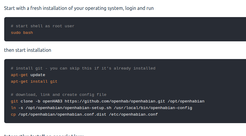

Here is what I have done to install:
  • per Documentation installed Openhabian:
  • enabled debug output in openhabian config file.
  • run openhabian-config, select option 03 to install OH3
  • after install, log into openHab webpage and create user (openhab)
  • reboot system
  • run openhabian-config, select option 20 - Install optional components
  • select option 21 - install logviewer frontail
Installation fails. Same result as the debug info as posted. The only file I have altered is to turn “debug=ON” for openhabian. I have not modified anything else. My installation is a fresh install from Linux Mint, with only Chrome Remote desktop and openhabian being the only software i have added to it.
