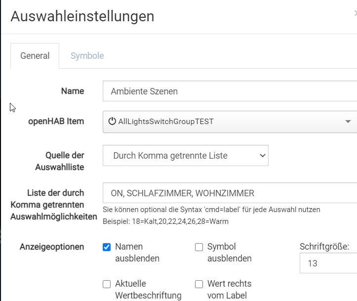

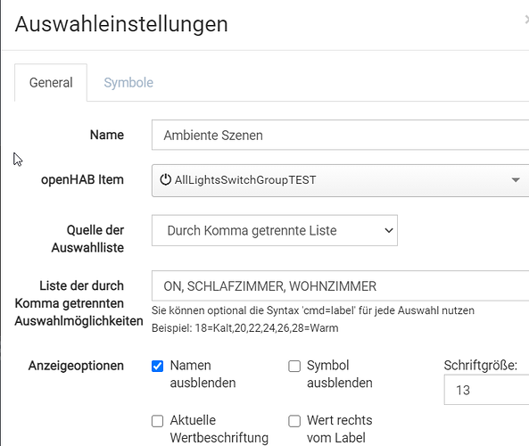

I have a multi-state switch in habpanel which I want to control different hue scenes with in different rooms.
Hence I have for every room a different string to control the scene which should fire:

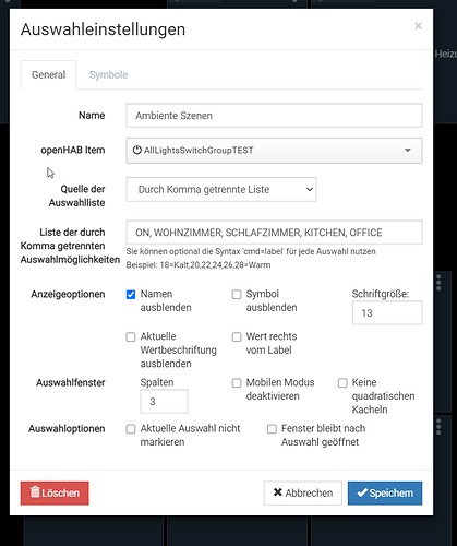

I believe the problem is that your item is a switch, which can only accept OnOff commands (unless that has changed in OH3?). You need to change it to a string, and then your original case statement should work.

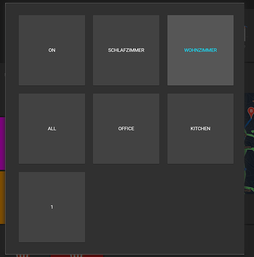

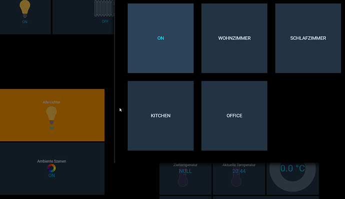

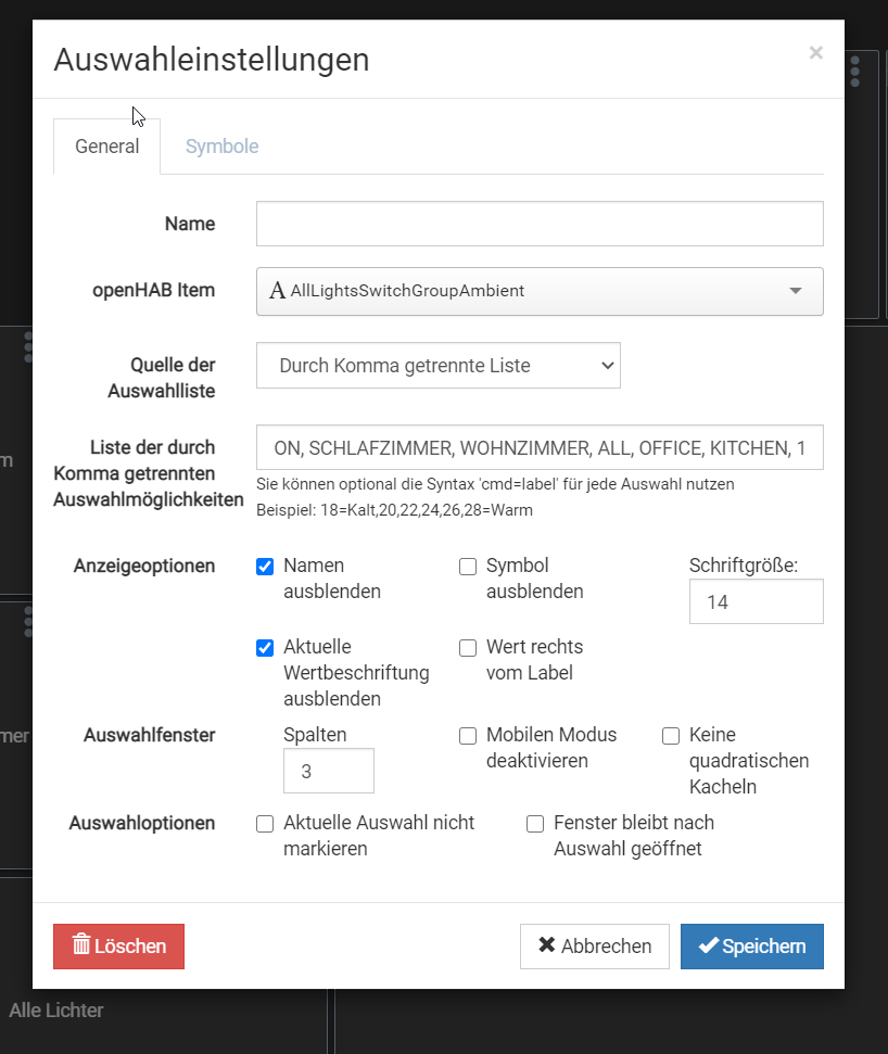

Thanks @rossko57, I had read about the Group Type issue and have a String here.
The reason was to just have some kind of helper item that gets passed state to be able to select different commands by the habpanel selection widget
Maybe there is a complete different approach and I am looking in the wrong style here?
I thought, that with the habpanel selection widget I want to be able seperately choose to fire seperate commands independant from the original Switch item in habpanel (like above in the rule)

Iâve now realized the Item with Group in the name is not a Group.
You donât care about itâs state at all, really (though you might use it in your UI)
