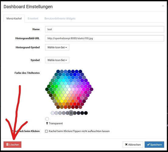

So I’ve been growing my HABPanel layout and now have dashboards that are no longer populated and no longer needed.
But, I can’t see a way to delete a dashboard.
Or, change a dashboard name.

Edit deshboards, Deshboard settings, Delete
I see no Delete under Settings.
There are trashcan items for panel configurations, But nothing for dashboards in those panels.
Obviously I’m missing something…
Aha. Took me a bit of poking around to find that and then the buttons were off the bottom of the browser window.
Thanks!
Where do I find this settings screen. I have been into different settings places and can’t seem to find it. Also is there a text file that I could just edit it in?
