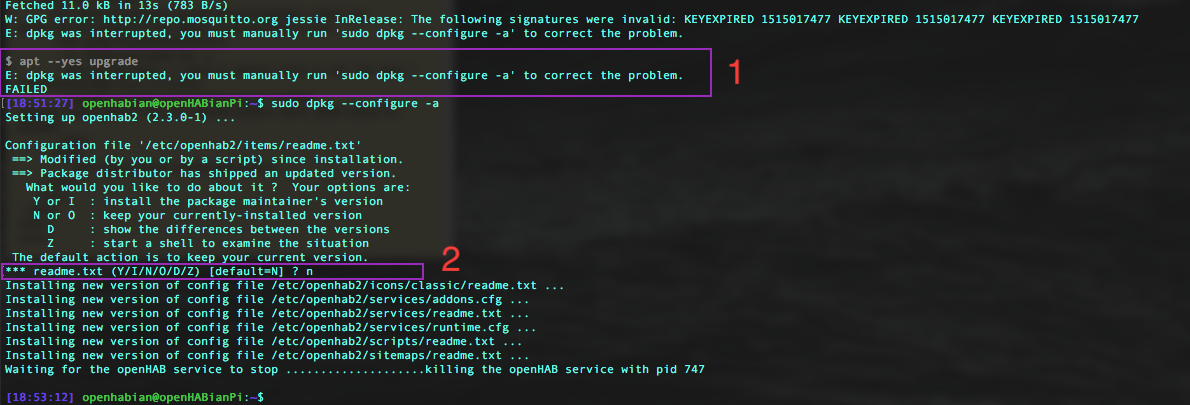

i think i got it fixed - OMG

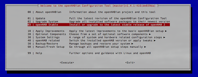

i closed the 50% update window after 1,5 h waiting and in a new shell back to the config tool
i clicked again on “openHAB Stable” and got this message (1) and run the command manually - after that i clicked “n” (2)

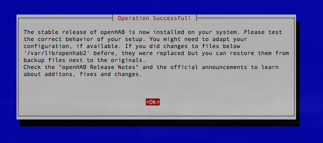

Then i saw something is happening in the LOG again - wohooo - after some seconds i got this:
i did a “sudo reboot” and now it looks like its working again - all my Bindings are gone - but i think i found all and reinstalled them
i think its done now … hope so
