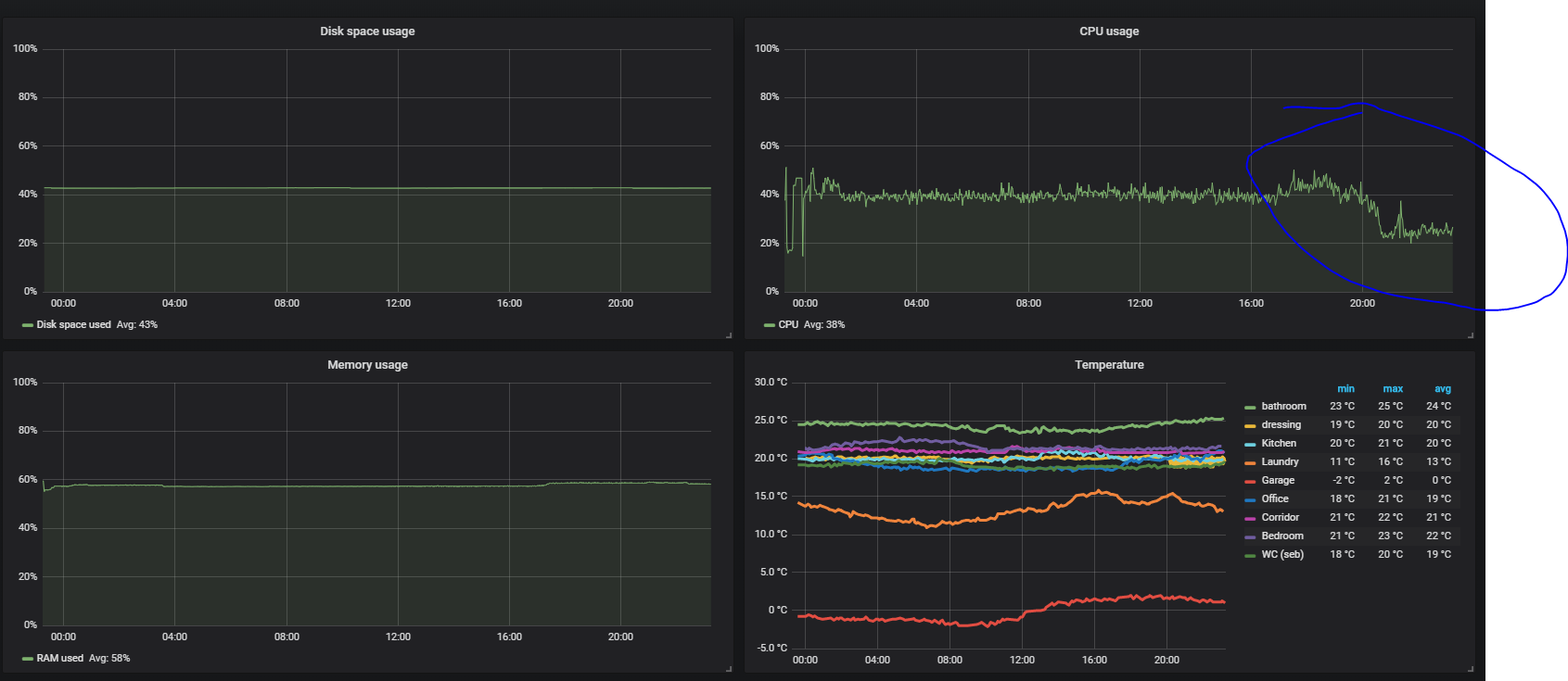

** 3. Is it related to raspberry pi resources ? **
I won’t say it’s not but if I run htop most of the time cpus are not all working and memory: 488/927

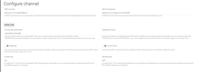

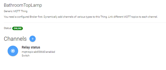

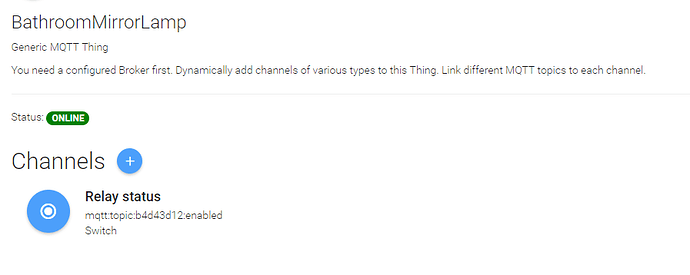

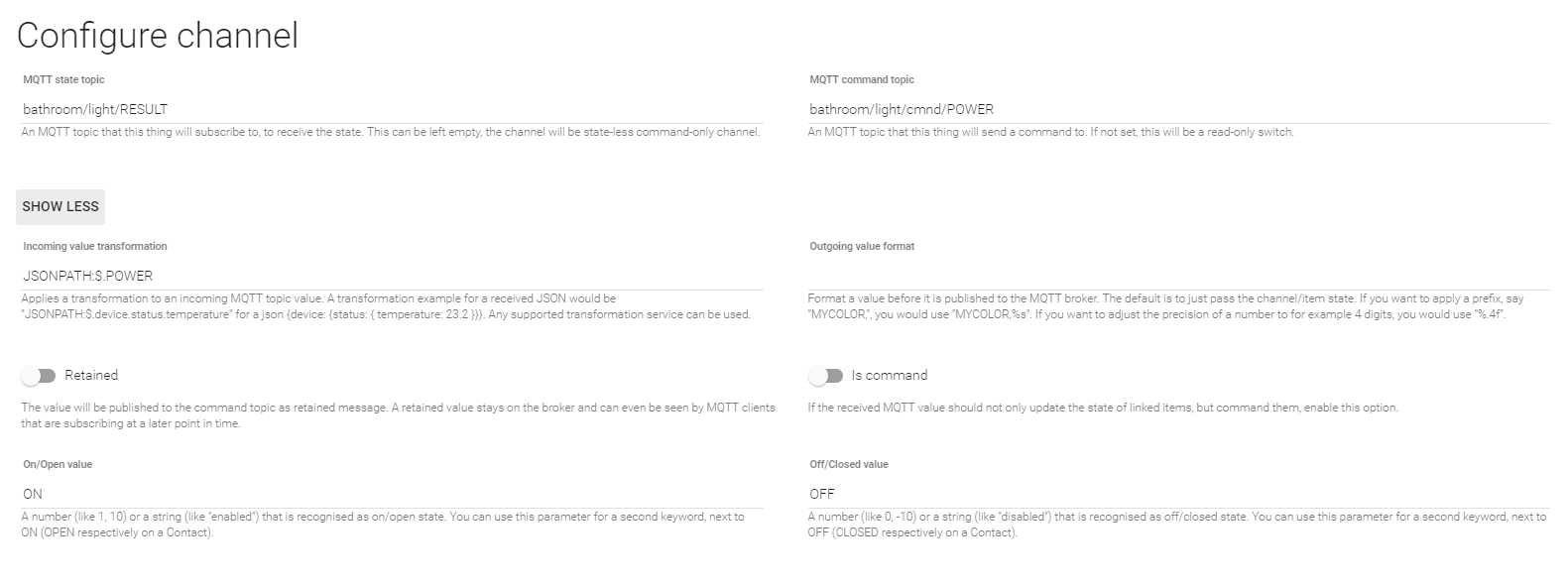

These two. You are using MQTTv2 binding. This is a very new binding and you may have come across a bug.
Can you post the detailed confid of these two items, s’il te plais.
Have you put these two items in a sitemap and how long does they take to turn on?
Indeed I had to upgrade since 2.4 and wanted to use the new way of doing as it looks less “hands on” than the OH 1 implementation.
So about the config for theses two items:

I removed all my http.cfg items. I discovered that now philips hue plugin supports motion, temperature and luminosity measurement natively so no more need for a polling hack on http.
It reduced the CPU usage:
But it is still a bit slow to react to UI switches. (2 seconds)
Is it an expected range of speed or can I still improve it ?
