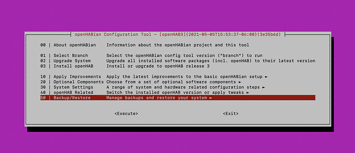

Hello there
i am running openhabian on my ubuntu vm and i have no “testing” option, neither do i have 60 manual/fresh setup when opening the config …
You do realize the menu options have likely changed in 2 years and a new thread should be created?
Sorry …
I also found it finally in the 40s.
