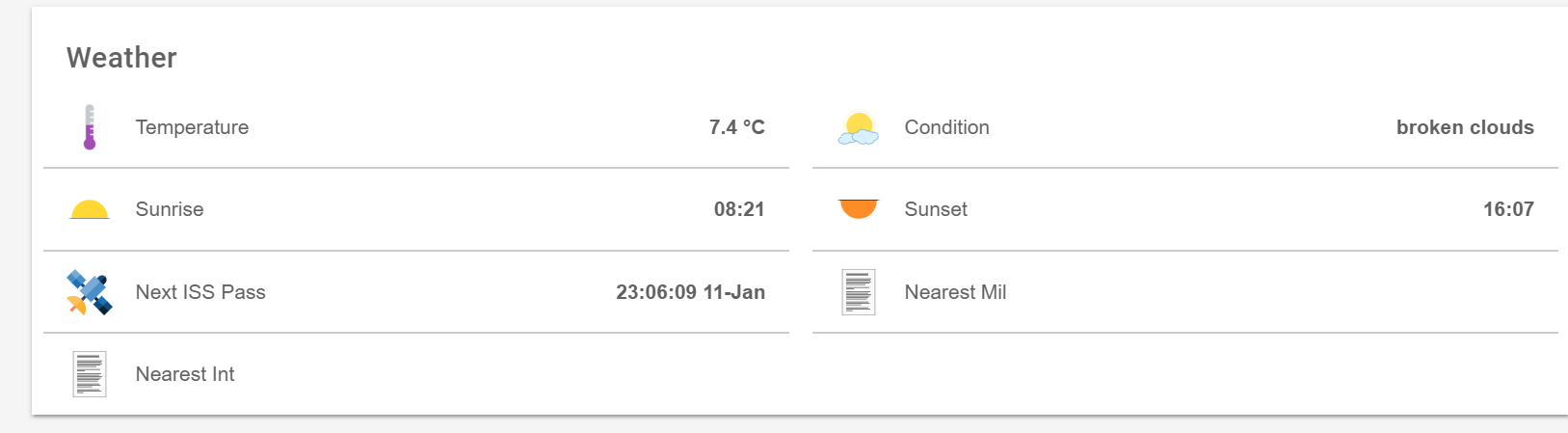

But the sitemap isn’t updating, even with an f5:
my items file has this line
String NearestInt "Nearest Int"
and my sitemap has this
Default item=NearestInt
Any ideas, i’m a little stumped.

Try changing the item like below and see what happens.
String NearestInt "Nearest Int [%s]"
I am an idiot. Thanks
