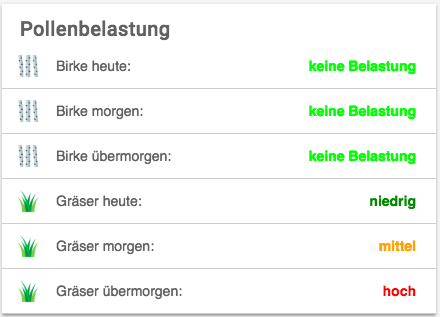

I’m querrying the Pollen exposure for the next 3 days:
Number PollenBirch_d0 "Birch today: [MAP(pollen.map):%s]" <birch> (Wetter) { http="<[http://192.xxx.xxx.xxx:8080/static/pollen.txt:60000:JSONPATH($.Birke[0].selection2[0].selection3[0].Belastung)]"}
Number PollenBirch_d1 "Birch tomorrow: [MAP(pollen.map):%s]" <birch> (Wetter) { http="<[http://192.xxx.xxx.xxx:8080/static/pollen.txt:60000:JSONPATH($.Birke[1].selection2[0].selection3[6].Belastung)]"}
Number PollenBirch_d2 "Birch day after tomorrow: [MAP(pollen.map):%s]" <birch> (Wetter) { http="<[http://192.xxx.xxx.xxx:8080/static/pollen.txt:60000:JSONPATH($.Birke[2].selection2[0].selection3[12].Belastung)]"}
Also, I’m transforming the querried data, which you can see in the transform file above.
In the above example, I’ve translated it into English.
The outcome in the sitemap looks like that (in German and showing birch and grass, as birch has no exposure currently where I’m living).
