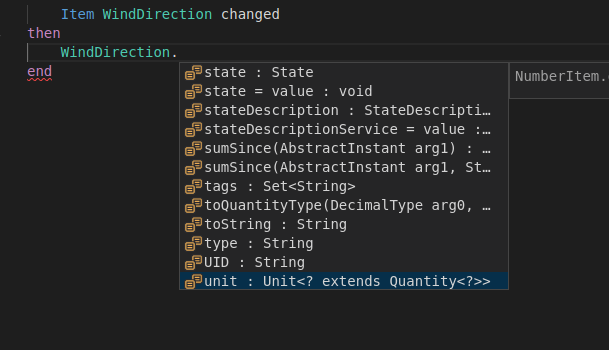

The tags are not accessible in the rules DSL
VS code shows:
Thanks Vincent, this is in a habpanel custom widget not a rule. Itemwithtag is a documented function but i cant see how it would work as coded, either it should be looking for tags property or my item schema is returning the wrong name.
