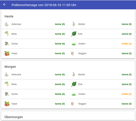

nice icons.
Could you please share it?
Unfortunately, I grabbed them from an online service (and built the svg version through CorelDraw), so I don’t have the copyright.
