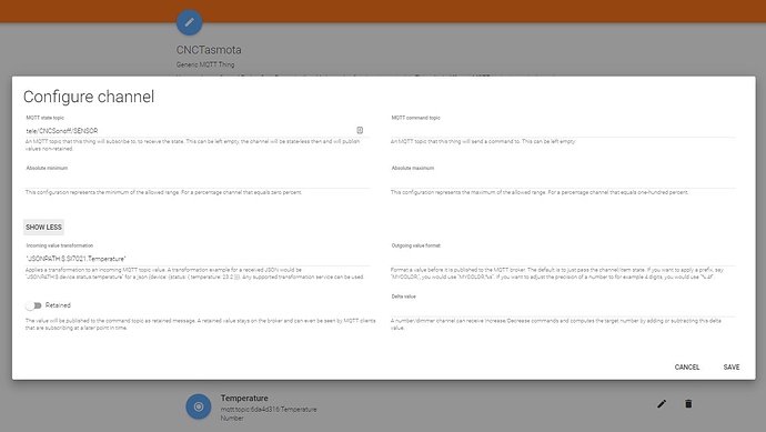

I’m looking to convert an incoming string from my Tasmota TH16 to items via an openhab rule, but am having a JSONPATH error. I haven’t really forrayed into this form of transformation before, so I have to admit I could be missing something fundameltal here.
My incoming string is a variation of this:
{“Time”:“2019-12-16T21:43:35”,“SI7021”:{“Temperature”:15.2,“Humidity”:57.8},“TempUnit”:“C”}
The string is stored in sonoffCNCRoom_Sensor_Raw via MQTT. This is working,
My rule triggers on sonoffCNCRoom_Sensor_Raw change, but throws an error.

Any pointers/suggestions? I’ve wandered many JSONPATH documentation sites, with little direction.
I’m guessing it may have something to do with how the temperature/humidity is nested within the string.
