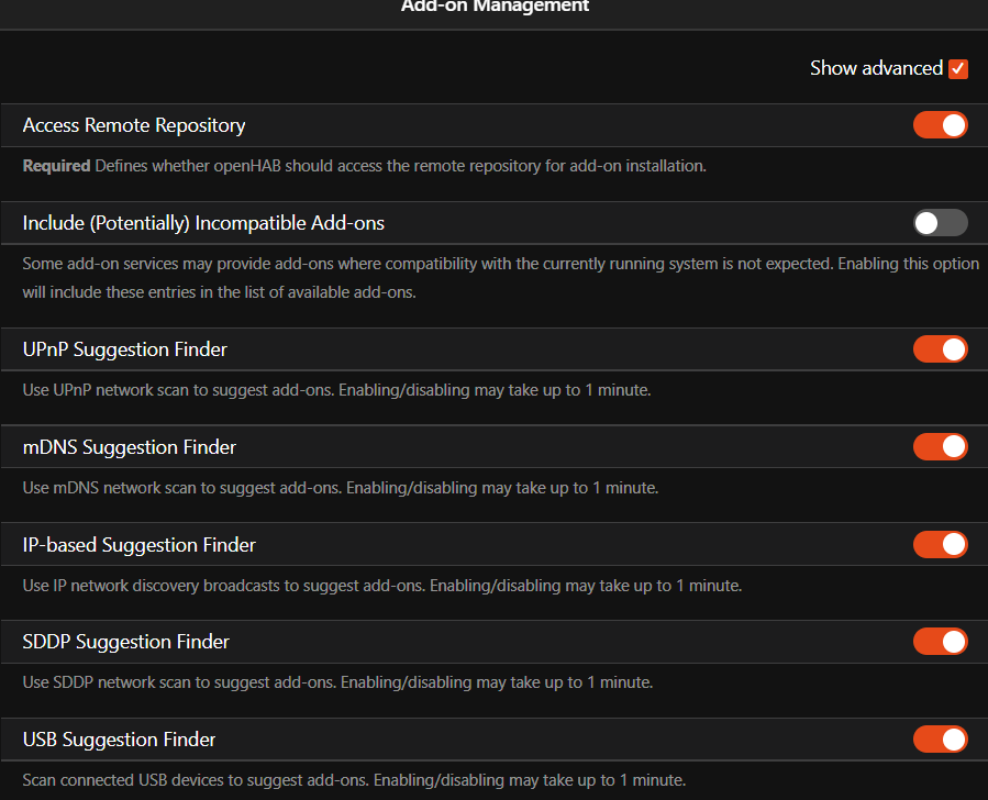

Settings … Add On Management … Show advanced
if you are reffering here
There is no such a thing, if you are reffering to each addon, which is not very systematic approach, then maybe - but eventho I have all discovery flags to false, it still writes those files to jsondb
I’m talking about disablig whole discovery service for everything
There isn’t one discovery service. Under Add-on Management, as you show, there are five discovery services which go out and search your network, plugged in devices, etc for indicators that you have a device or technology which openHAB has an add-on which can be used to integrate that device or technology with OH.

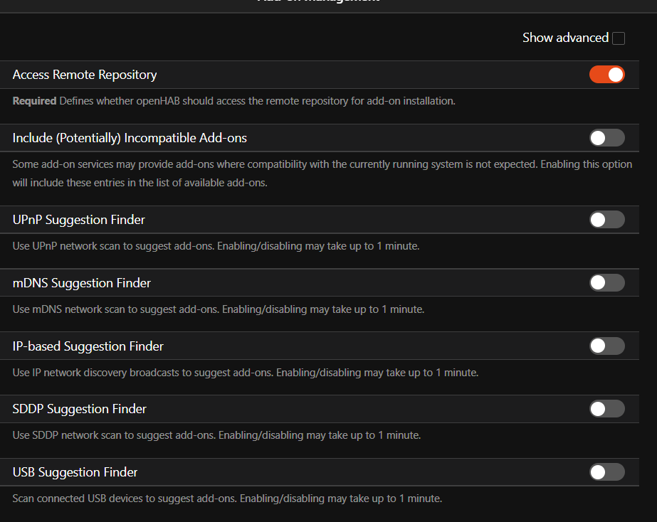

To prevent every change from turning into two writes, in that same settings page you can change the number of backup files to 0. Of course that disables the backups so you’d be taking on that risk.
As I explained above, those settings are to control how openHAB goes out and searches your computer and network for devices for which OH has an addon. That’s how the “suggested add-ons” section gets populated in the Add-on store.
They have nothing to do with Things and the DiscoveryResult.json file.
