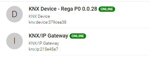

Starting about the issue, have created the KNX interface, with no issues, as you can see the status is Online.

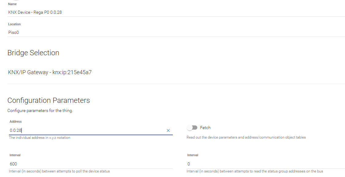

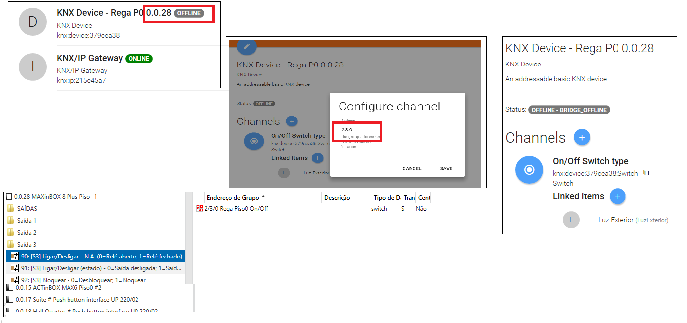

Please find the details about this:
Bridge online.
KNX Device Physical Address: 0.0.28
KNX Group Address: 2.3.0
have added also the ETS addresses for your confirming.

What are the parameters of your device? What does the log say?
P.S.: Are you sure your gateway is online?

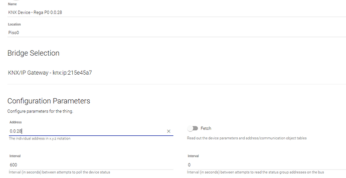

As a first test, please leave address for the Thing empty as well as localSourceAddr for the Bridge.
The Group Addresses are written with slashes instead of dots, so your GA should be read as 2/3/0, not 2.3.0 (This part is the channel config)

If I remove the Thing/Device address and remove the localSourceAddr in the Bridge I have this result:

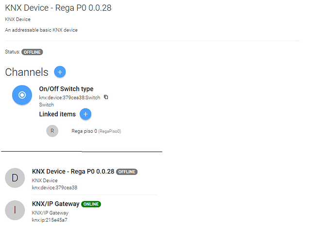

The gateway is working. And if i change it to other IP it comes offline. So I’m assuming it is online for Openhab.
Parameters:

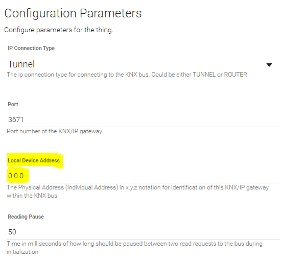

Hi folks
Fixed the issue.
I have changed the Local Device Address, in the bridge, from 0.0.50 to 0.0.0 and it solved.
