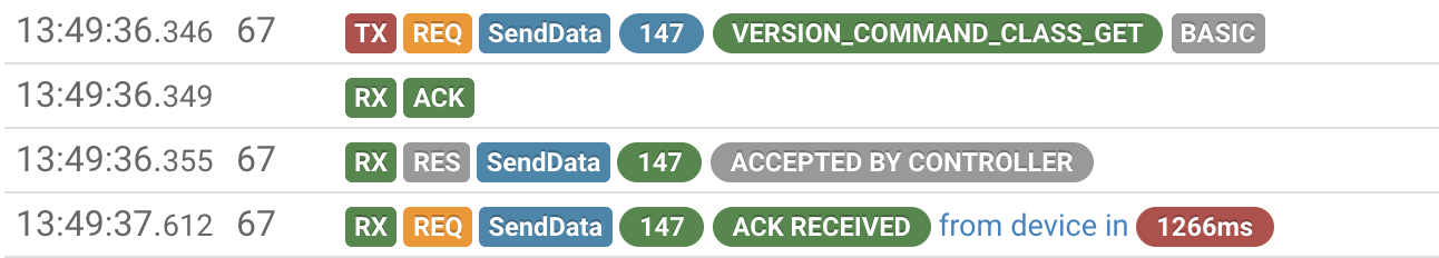

ACKS will normally take this amount of time on a FLIRS device as the device does not listen all the time. If the device is awake, it will process quickly, if not, it will process when it next wakes dependant on it’s FLIRS cycle.
