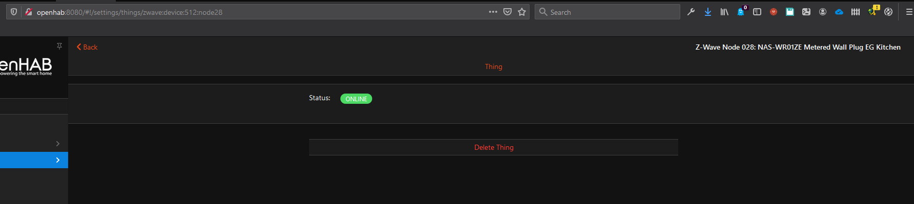

The latest Zwave database update made my older Neo Coolcam plugs not to be recognized anymore.
before updating from 3.1.0-SNAPSHOT - Build #2111
to 3.1.0-SNAPSHOT - Build #2115
they worked without any issues.

Has the entry in the database for the NAS-WR01ZE changed recently?
What/where do I need to correct this?
