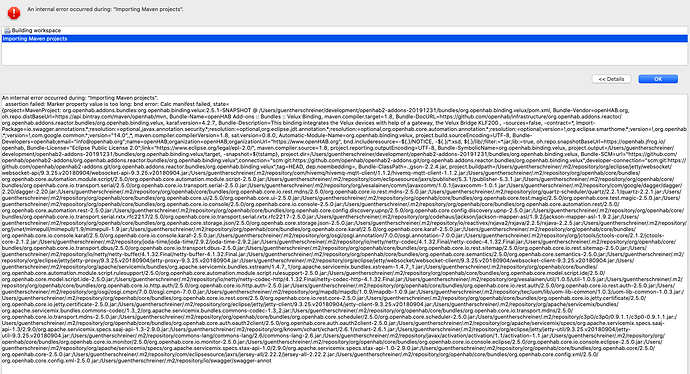

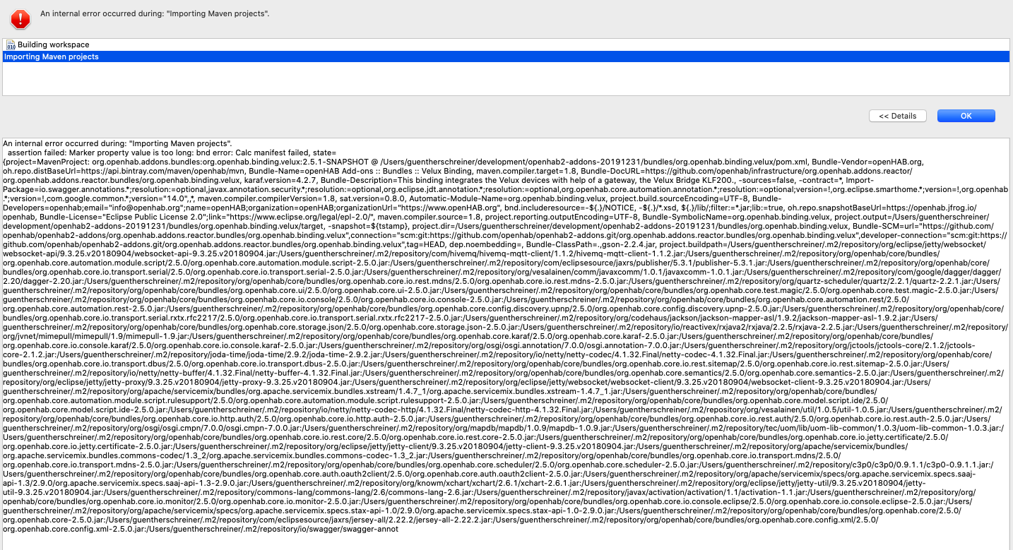

Just FYI: Update to 2.5.1 partially failed with the following details:
  • mvn run with success: Now, all files below ESH-INF are filled with content again :smiley:
  • Eclipse gives up :disappointed_relieved: with many unresolved imports (org.apache, org.eclipse, org.slf4j a.s.o).

For an impressum here are the toplevel errors of the new environment:
Multiple annotations found at this line:
- Missing artifact com.github.tavalin.orvibo-sdk:s20-sdk:jar:0.0.6-nmu1
- Missing artifact org.openhab.binding.tado:api-client:jar:1.3.0
- Failure to transfer com.github.tavalin.orvibo-sdk:s20-sdk:jar:0.0.6-nmu1 from JFrog was cached in the local repository, resolution will not be reattempted
until the update interval of openhab-release has elapsed or updates are forced. Original error: Could not transfer artifact com.github.tavalin.orvibo-sdk:s20-sdk:jar:0.0.6-nmu1 from/to openhab-release
(JFrog): openhab.jfrog.io org.eclipse.aether.transfer.ArtifactTransferException: Failure to transfer com.github.tavalin.orvibo-sdk:s20-sdk:jar:0.0.6-nmu1 from
JFrog was cached in the local repository, resolution will not be reattempted until the update interval of openhab-release has elapsed or updates are forced.
Original error: Could not transfer artifact com.github.tavalin.orvibo-sdk:s20-sdk:jar:0.0.6-nmu1 from/to openhab-release (JFrog): openhab.jfrog.io at
org.eclipse.aether.internal.impl.DefaultUpdateCheckManager.newException(DefaultUpdateCheckManager.java:240) at
org.eclipse.aether.internal.impl.DefaultUpdateCheckManager.checkArtifact(DefaultUpdateCheckManager.java:208) at
org.eclipse.aether.internal.impl.DefaultArtifactResolver.gatherDownloads(DefaultArtifactResolver.java:563) at
org.eclipse.aether.internal.impl.DefaultArtifactResolver.performDownloads(DefaultArtifactResolver.java:481) at org.eclipse.aether.internal.impl.DefaultArtifactResolver.resolve(DefaultArtifactResolver.java:
399) at org.eclipse.aether.internal.impl.DefaultArtifactResolver.resolveArtifacts(DefaultArtifactResolver.java:224) at

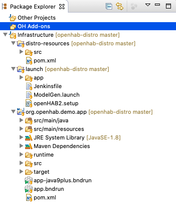

The new Eclipse setup with selection of
  • openHAB development plus
  • openHAB addons
provides a more-or-less empty IDE (no bindings!):
That’s because it checks out the master branch, which doesn’t contain any addons at the moment. You need to manually switch both addons and distro to 2.5.x branch. But why do you build the whole addons repo or import it? It’s far more simpler to just copy/clone your own addons repo and build/import only the bindings you actually develop on.

This leads to lot of errors:
An internal error occurred during: "Update Maven projects configuration".
assertion failed: Marker property value is too long: bnd error: Calc manifest failed, state=
{project=MavenProject: org.openhab.addons.bundles:org.openhab.binding.velux:2.5.1-SNAPSHOT @ /Users/guentherschreiner/development/openhab2-addons-20191231/bundles/org.openhab.binding.velux/pom.xml, Bundle-Vendor=openHAB.org, oh.repo.distBaseUrl=https://api.bintray.com/maven/openhab/mvn, Bundle-Name=openHAB Add-ons :: Bundles :: Velux Binding, maven.compiler.target=1.8, Bundle-DocURL=https://github.com/openhab/infrastructure/org.openhab.addons.reactor/org.openhab.addons.reactor.bundles/org.openhab.binding.velux, karaf.version=4.2.7, Bundle-Description=This binding integrates the Velux devices with help of a gateway, the Velux Bridge KLF200., -sources=false, -contract=*, Import-Package=io.swagger.annotations.*;resolution:=optional,javax.annotation.security.*;resolution:=optional,org.eclipse.jdt.annotation.*;resolution:=optional,org.openhab.core.automation.annotation.*;resolution:=optional;version=!,org.eclipse.smarthome.*;version=!,org.openhab.*;version=!,com.google.common.*;version="14.0",,*, maven.compiler.compilerVersion=1.8, sat.version=0.8.0, Automatic-Module-Name=org.openhab.binding.velux, project.build.sourceEncoding=UTF-8, Bundle-Developers=openhab;email="info@openhab.org";name=openHAB;organization=openHAB;organizationUrl="https://www.openHAB.org", bnd.includeresource=-${.}/NOTICE, -${.}/*.xsd, ${.}/lib/;filter:=*.jar;lib:=true, oh.repo.snapshotBaseUrl=https://openhab.jfrog.io/openhab, Bundle-License="Eclipse Public License 2.0";link="https://www.eclipse.org/legal/epl-2.0/", maven.compiler.source=1.8, project.reporting.outputEncoding=UTF-8, Bundle-SymbolicName=org.openhab.binding.velux, project.output=/Users/guentherschreiner/development/openhab2-addons-20191231/bundles/org.openhab.binding.velux/target, -snapshot=${tstamp}, project.dir=/Users/guentherschreiner/development/openhab2-addons-20191231/bundles/org.openhab.binding.velux, Bundle-SCM=url="https://github.com/openhab/openhab2-addons/org.openhab.addons.reactor.bundles/org.openhab.binding.velux",connection="scm:git:https://github.com/openhab/openhab2-addons.git/org.openhab.addons.reactor.bundles/org.openhab.binding.velux",developer-connection="scm:git:https://github.com/openhab/openhab2-addons.git/org.openhab.addons.reactor.bundles/org.openhab.binding.velux",tag=HEAD, dep.noembedding=, Bundle-ClassPath=.,gson-2.2.4.jar, project.buildpath=/Users/guentherschreiner/.m2/repository/org/osgi/osgi.core/6.0.0/osgi.core-6.0.0.jar:/Users/guentherschreiner/.m2/repository/org/osgi/osgi.cmpn/7.0.0/osgi.cmpn-7.0.0.jar:/Users/guentherschreiner/.m2/repository/org/osgi/osgi.annotation/7.0.0/osgi.annotation-7.0.0.jar:/Users/guentherschreiner/.m2/repository/org/slf4j/slf4j-api/1.7.21/slf4j-api-1.7.21.jar:/Users/guentherschreiner/.m2/repository/org/eclipse/jdt/org.eclipse.jdt.annotation/2.2.100/org.eclipse.jdt.annotation-2.2.100.jar:/Users/guentherschreiner/.m2/repository/javax/annotation/javax.annotation-api/1.2/javax.annotation-api-1.2.jar:/Users/guentherschreiner/.m2/repository/commons-collections/commons-collections/3.2.1/commons-collections-3.2.1.jar:/Users/guentherschreiner/.m2/repository/org/apache/commons/commons-exec/1.1/commons-exec-1.1.jar:/Users/guentherschreiner/.m2/repository/org/apache/servicemix/bundles/org.apache.servicemix.bundles.commons-httpclient/3.1_7/org.apache.servicemix.bundles.commons-httpclient-3.1_7.jar:/Users/guentherschreiner/.m2/repository/commons-logging/commons-logging/1.0.4/commons-logging-1.0.4.jar:/Users/guentherschreiner/.m2/repository/org/apache/servicemix/bundles/org.apache.servicemix.bundles.commons-codec/1.3_2/org.apache.servicemix.bundles.commons-codec-1.3_2.jar:/Users/guentherschreiner/.m2/repository/commons-io/commons-io/2.2/commons-io-2.2.jar:/Users/guentherschreiner/.m2/repository/commons-lang/commons-lang/2.6/commons-lang-2.6.jar:/Users/guentherschreiner/.m2/repository/org/eclipse/californium/californium-core/2.0.0/californium-core-2.0.0.jar:/Users/guentherschreiner/.m2/repository/org/eclipse/californium/scandium/2.0.0/scandium-2.0.0.jar:/Users/guentherschreiner/.m2/repository/org/eclipse/californium/element-connector/2.0.0/element-connector-2.0.0.jar:/Users/guentherschreiner/.m2/repository/com/eclipsesource/jaxrs/publisher/5.3.1/publisher-5.3.1.jar:/Users/guentherschreiner/.m2/repository/com/eclipsesource/jaxrs/jersey-all/2.22.2/jersey-all-2.22.2.jar:/Users/guentherschreiner/.m2/repository/org/eclipse/orbit/bundles/com.google.gson/2.8.2.v20180104-1110/com.google.gson-2.8.2.v20180104-1110.jar:/Users/guentherschreiner/.m2/repository/com/igormaznitsa/jbbp/1.4.1/jbbp-1.4.1.jar:/Users/guentherschreiner/.m2/repository/org/codehaus/jackson/jackson-core-asl/1.9.2/jackson-core-asl-1.9.2.jar:/Users/guentherschreiner/.m2/repository/org/codehaus/jackson/jackson-mapper-asl/1.9.2/jackson-mapper-asl-1.9.2.jar:/Users/guentherschreiner/.m2/repository/org/eclipse/jetty/jetty-client/9.3.25.v20180904/jetty-client-9.3.25.v20180904.jar:/Users/guentherschreiner/.m2/repository/org/eclipse/jetty/jetty-http/9.3.25.v20180904/jetty-http-9.3.25.v20180904.jar:/Users/guentherschreiner/.m2/repository/org/eclipse/jetty/jetty-io/9.3.25.v20180904/jetty-io-9.3.25.v20180904.jar:/Users/guentherschreiner/.m2/repository/org/eclipse/jetty/jetty-proxy/9.3.25.v20180904/jetty-proxy-9.3.25.v20180904.jar:/Users/guentherschreiner/.m2/repository/org/eclipse/jetty/jetty-util/9.3.25.v20180904/jetty-util-9.3.25.v20180904.jar:/Users/guentherschreiner/.m2/repository/org/eclipse/jetty/jetty-server/9.3.25.v20180904/jetty-server-9.3.25.v20180904.jar:/Users/guentherschreiner/.m2/repository/org/eclipse/jetty/jetty-servlet/9.3.25.v20180904/jetty-servlet-9.3.25.v20180904.jar:/Users/guentherschreiner/.m2/repository/org/eclipse/jetty/jetty-security/9.3.25.v20180904/jetty-security-9.3.25.v20180904.jar:/Users/guentherschreiner/.m2/repository/org/eclipse/jetty/websocket/websocket-client/9.3.25.v20180904/websocket-client-9.3.25.v20180904.jar:/Users/guentherschreiner/.m2/repository/org/eclipse/jetty/websocket/websocket-common/9.3.25.v20180904/websocket-common-9.3.25.v20180904.jar:/Users/guentherschreiner/.m2/repository/org/eclipse/jetty/websocket/websocket-api/9.3.25.v20180904/websocket-api-9.3.25.v20180904.jar:/Users/guentherschreiner/.m2/repository/org/jmdns/jmdns/3.5.5/jmdns-3.5.5.jar:/Users/guentherschreiner/.m2/repository/joda-time/joda-time/2.9.2/joda-time-2.9.2.jar:/Users/guentherschreiner/.m2/repository/org/jupnp/org.jupnp/2.5.2/org.jupnp-2.5.2.jar:/Users/guentherschreiner/.m2/repository/org/mapdb/mapdb/1.0.9/mapdb-1.0.9.jar:/Users/guentherschreiner/.m2/repository/javax/measure/unit-api/1.0/unit-api-1.0.jar:/Users/guentherschreiner/.m2/repository/tec/uom/uom-se/1.0.10/uom-se-1.0.10.jar:/Users/guentherschreiner/.m2/repository/tec/uom/lib/uom-lib-common/1.0.3/uom-lib-common-1.0.3.jar:/Users/guentherschreiner/.m2/repository/com/hivemq/hivemq-mqtt-client/1.1.2/hivemq-mqtt-client-1.1.2.jar:/Users/guentherschreiner/.m2/repository/io/reactivex/rxjava2/rxjava/2.2.5/rxjava-2.2.5.jar:/Users/guentherschreiner/.m2/repository/org/reactivestreams/reactive-streams/1.0.2/reactive-streams-1.0.2.jar:/Users/guentherschreiner/.m2/repository/io/netty/netty-handler/4.1.32.Final/netty-handler-4.1.32.Final.jar:/Users/guentherschreiner/.m2/repository/io/netty/netty-buffer/4.1.32.Final/netty-buffer-4.1.32.Final.jar:/Users/guentherschreiner/.m2/repository/io/netty/netty-transport/4.1.32.Final/netty-transport-4.1.32.Final.jar:/Users/guentherschreiner/.m2/repository/io/netty/netty-resolver/4.1.32.Final/netty-resolver-4.1.32.Final.jar:/Users/guentherschreiner/.m2/repository/io/netty/netty-codec/4.1.32.Final/netty-codec-4.1.32.Final.jar:/Users/guentherschreiner/.m2/repository/io/netty/netty-codec-http/4.1.32.Final/netty-codec-http-4.1.32.Final.jar:/Users/guentherschreiner/.m2/repository/io/netty/netty-transport-native-epoll/4.1.32.Final/netty-transport-native-epoll-4.1.32.Final-linux-x86_64.jar:/Users/guentherschreiner/.m2/repository/io/netty/netty-common/4.1.32.Final/netty-common-4.1.32.Final.jar:/Users/guentherschreiner/.m2/repository/io/netty/netty-transport-native-unix-common/4.1.32.Final/netty-transport-native-unix-common-4.1.32.Final.jar:/Users/guentherschreiner/.m2/repository/org/jctools/jctools-core/2.1.2/jctools-core-2.1.2.jar:/Users/guentherschreiner/.m2/repository/org/jetbrains/annotations/16.0.3/annotations-16.0.3.jar:/Users/guentherschreiner/.m2/repository/com/google/dagger/dagger/2.20/dagger-2.20.jar:/Users/guentherschreiner/.m2/repository/javax/inject/javax.inject/1/javax.inject-1.jar:/Users/guentherschreiner/.m2/repository/org/quartz-scheduler/quartz/2.2.1/quartz-2.2.1.jar:/Users/guentherschreiner/.m2/repository/c3p0/c3p0/0.9.1.1/c3p0-0.9.1.1.jar:/Users/guentherschreiner/.m2/repository/org/quartz-scheduler/quartz-jobs/2.2.1/quartz-jobs-2.2.1.jar:/Users/guentherschreiner/.m2/repository/org/vesalainen/comm/javaxcomm/1.0.1/javaxcomm-1.0.1.jar:/Users/guentherschreiner/.m2/repository/org/vesalainen/comm/1.0.2/comm-1.0.2.jar:/Users/guentherschreiner/.m2/repository/org/vesalainen/dev/1.0.0/dev-1.0.0.jar:/Users/guentherschreiner/.m2/repository/org/vesalainen/util/1.0.5/util-1.0.5.jar:/Users/guentherschreiner/.m2/repository/com/googlecode/efficient-java-matrix-library/equation/0.26/equation-0.26.jar:/Users/guentherschreiner/.m2/repository/com/googlecode/efficient-java-matrix-library/core/0.26/core-0.26.jar:/Users/guentherschreiner/.m2/repository/log4j/log4j/1.2.17/log4j-1.2.17.jar:/Users/guentherschreiner/.m2/repository/com/neuronrobotics/nrjavaserial/3.14.0/nrjavaserial-3.14.0.jar:/Users/guentherschreiner/.m2/repository/commons-net/commons-net/3.3/commons-net-3.3.jar:/Users/guentherschreiner/.m2/repository/javax/servlet/javax.servlet-api/3.1.0/javax.servlet-api-3.1.0.jar:/Users/guentherschreiner/.m2/repository/io/swagger/swagger-annotations/1.5.5/swagger-annotations-1.5.5.jar:/Users/guentherschreiner/.m2/repository/javax/ws/rs/javax.ws.rs-api/2.0.1/javax.ws.rs-api-2.0.1.jar:/Users/guentherschreiner/.m2/repository/org/apache/servicemix/bundles/org.apache.servicemi
Next try:
  • Fresh Eclipse installation with selection of openHAB development (no selection of openHAB addons)
  • Import the complete git repository with the new binding.
  • This leads to errors (look more or less similar).

  • Import the complete git repository with the new binding as “importing maven projects”.
  • This leads to another error message
An internal error occurred during: “Importing Maven projects”.
Here the complete failure message:

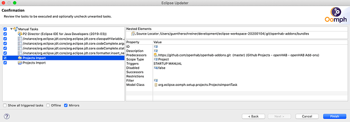

Next try (Thanks @hilbrand) :
  • Cleaning Eclipse pool directory ~/.p2/
  • Install Eclipse IDE for Java Developers (2019-03, bundle pool enabled).
  • Choose openHAB Development plus openHAB Addons.
  • Project area openHAB-Addons is empty, now.
  • Choose ImportMavenExisting Maven Projects with Root Directory the source of binding directory and working-Set “OH Add-Ons”:
    (the Projects list shows the pom.xml, select only this one)
  • Finished.
Perhaps the first step is essential.
