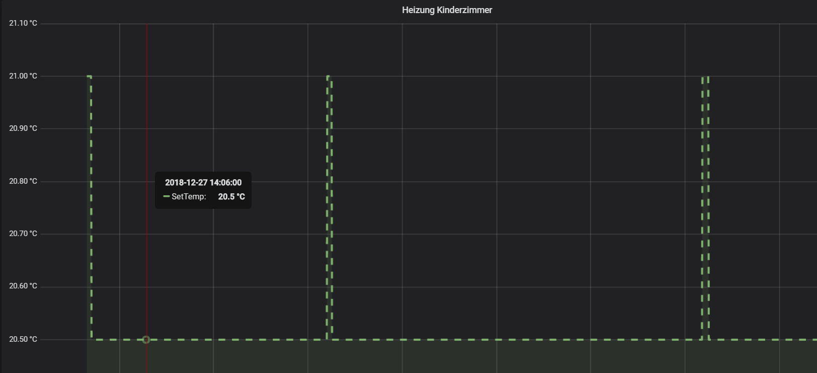

Without openHAB, the thermostats working without “surprise”. As the mode is set to Manu, all temperatures stay constant (exception: open Window)
I’ll try again with adding the thermostats Thing by Thing and find out when the unwished tempchange happens. I’ll start with the first room with two thermostats.
but this is a long journey and nothing I enjoy doing…but I don’t have ideas to find the root cause…
nobody in the room and no rule active…

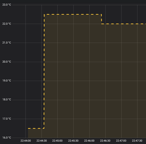

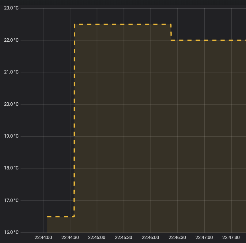

(update of the 3 last thermostats was a little bit later
27-Dec-2018 22:46:05.910 [INFO ] [.smarthome.model.core.internal.ModelRepositoryImpl] - Refreshing model ‘max.things’)
one of the thermostats of the sleeping room has now the same temp as the thermostat of the bathroom…
I had a similar problem (years ago). Two thermostats switched each other or in parallel. I removed both completely from Max!Cube. Then I did a factory reset of both thermostats. Then I added them with other names back to Cube. Then the error was gone forever.
