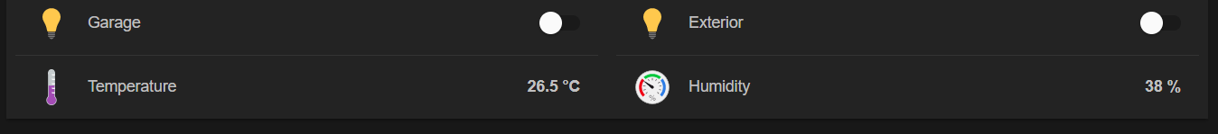

Greetings everyone so I flashed Tasmota onto a NodeMCU v3, and hooked up a DTH11 (temp & humidity sensor) to it, which works fine, however I’m having trouble with the configuration for openHAB. I already had a look through some posts here, and the Tasmota article, and tried to configure it through both PaperUI and the config files, without much luck.

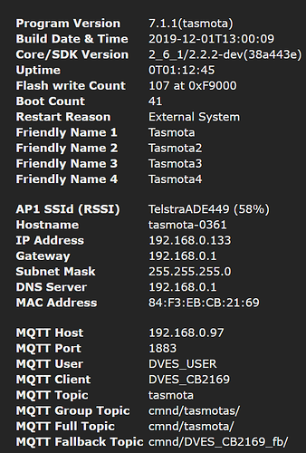

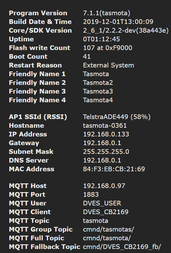

Here you go,if this is what you meant.

Oh boy, works like a charm now, thanks guys. I though I’m supposed to use the topic in the info file I posted above. Don’t worry about the relays, there aren’t any physical ones connected to the module yet, was just playing around.
