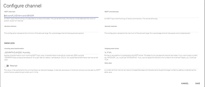

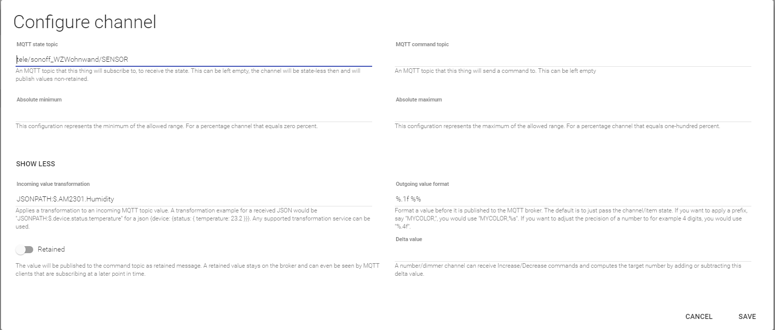

I had the same problem, you must add the JSON Path like
JSONPATH:$.AM2301.Humidity
for the Sensor Sorry but i can´t tell you how to add the Path because I´m using the Paper Ui to add my items.
Show her, to add the JSON Path
