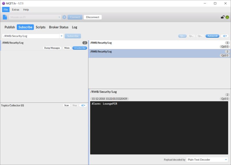

I am integrating OH2 on RPi with a custom security app on ardquino. Generally, this is working well, except that sometimes MQTT messages are not picked up by OH2. Restarting mosquitto does not fix the problem. Restarting OH2 generally does fix the problem.
I can confirm messages are sent by using MQTT.fx to subscribe to the topic. The event log shows no response … see attached image.
The item that does not always get updated:
String EventLog "xxx[%s]" (gEventInternal) {mqtt="<[broker:/RWB/Security/Log:state:default]"}

It is curious, as other items ties to different MQTT topics continue to work fine while this one.
tail of eventlog:
2018-12-15 15:17:30.835 [vent.ItemStateChangedEvent] - SecuritySystemMode changed from 1 to 5
2018-12-15 15:17:30.842 [vent.ItemStateChangedEvent] - SirenCount changed from 0 to 1
2018-12-15 15:17:30.970 [vent.ItemStateChangedEvent] - LoungePIR changed from 1 to 4
2018-12-15 15:17:31.017 [vent.ItemStateChangedEvent] - AlarmUpdate changed from 2018-12-15T15:17:27.415+1000 to 2018-12-15T15:17:30.970+1000
2018-12-15 15:17:40.971 [vent.ItemStateChangedEvent] - SecuritySystemMode changed from 5 to 1
2018-12-15 15:17:41.072 [vent.ItemStateChangedEvent] - LoungePIR changed from 4 to 1
2018-12-15 15:17:41.081 [vent.ItemStateChangedEvent] - AlarmUpdate changed from 2018-12-15T15:17:30.970+1000 to 2018-12-15T15:17:40.992+1000
2018-12-15 15:17:52.601 [vent.ItemStateChangedEvent] - AlarmUpdate changed from 2018-12-15T15:17:40.992+1000 to 2018-12-15T15:17:52.549+1000
LoungePIR for example, is getting the MQTT message - it is configured as:
Number HallPIR <motion> (gSecurity, gHouse, gInternal) {mqtt="<[broker:/RWB/Security/HallwayPIR:state:default]"}
Number LoungePIR <motion> (gSecurity, gHouse, gInternal) {mqtt="<[broker:/RWB/Security/LoungePIR:state:default]"}
but nothing for “EventLog”.
