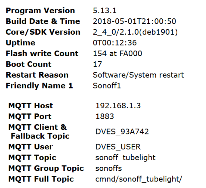

Tasmota configuration

When I toggle via GUI I can below logs but nothing in [mosquitto_sub -h 192.168.1.3 -v -t “#”]
2018-10-24 00:36:23.444 [ome.event.ItemCommandEvent] - Item 'sonoff_tubelight' received command OFF
2018-10-24 00:36:23.476 [vent.ItemStateChangedEvent] - sonoff_tubelight changed from ON to OFF
2018-10-24 00:36:24.656 [ome.event.ItemCommandEvent] - Item 'sonoff_tubelight' received command ON
2018-10-24 00:36:24.679 [vent.ItemStateChangedEvent] - sonoff_tubelight changed from OFF to ON
2018-10-24 00:36:25.689 [ome.event.ItemCommandEvent] - Item 'sonoff_tubelight' received command OFF
2018-10-24 00:36:25.700 [vent.ItemStateChangedEvent] - sonoff_tubelight changed from ON to OFF
2018-10-24 00:36:26.260 [ome.event.ItemCommandEvent] - Item 'sonoff_tubelight' received command ON
2018-10-24 00:36:26.269 [vent.ItemStateChangedEvent] - sonoff_tubelight changed from OFF to ON
When I toggle via " mosquitto_pub -h 192.168.1.3 -t “cmnd/sonoff_tubelight/power” -m “toggle” but nothing in logs
cmnd/sonoff_tubelight/power toggle
stat/sonoff_tubelight/RESULT {"POWER":"OFF"}
stat/sonoff_tubelight/POWER OFF
