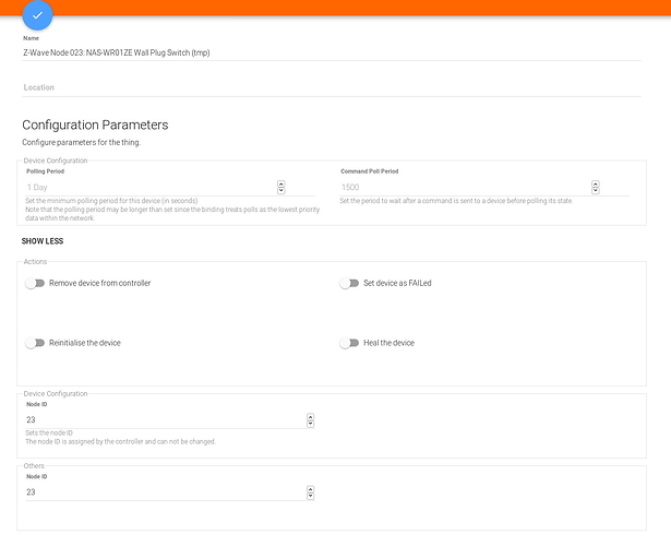

I got a new batch of devices, this time with firmware 2.23. I previously had devices with versions 2.32 and 3.94:

The 2.23 device seems to be found just fine but there’s nothing to be configured besides polling:
How do I determine if a database update is required to configure it properly or if the older firmware just is very limited?
Thanks,
Torkil
Hello. You should update the version of z-wave binding. This issue was resolved with one of the last database updates. Also it was discussed in this thread [SOLVED] NEO Wallplug (NAS-WR01ZE) is in the database but is shown as Unknown Device - #13 by Majestry
Thanks, last instructions worked almost to the letter.
