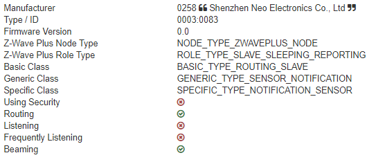

I now have 2 NeoCam PIR sensors with a different ID than my previous one. I initially got them in OH and identified. When I started trying to use one of them, I suspected the Thing may not have been fully initializes, so I removed the Thing and rediscovered.it onluyshows ad “Unknown Device” with no IDs.
I notice neither sensors have xml files produced. Here is the info from one of them when first discovered.
How do we want to troubleshoot this?
I suspect that it’s only partly completed the initialisation. There are type/id’s defined, so it knows the manufacturer data, but firmware version is 0, so that is the missing bit of information required to determine the thing type.
My guess is that it needs to be woken up to finish discovery, but if you’ve done that a few times and it’s not getting there, then please provide a debug log and I’ll take a look.
