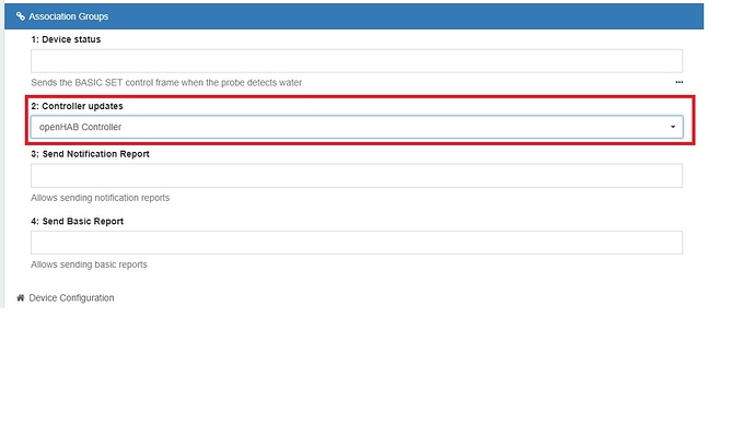

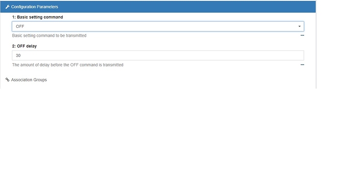

I have a new Neo Coolcam Water sensor included and identified in my system (openHAB 2.3.0-1 (Release Build).
Node is communicating with controller but when water is detected only messages are received but items state does not change of update.
I simply check the state of the Binary Sensor channel switch for ON. Is it working for anyone?
