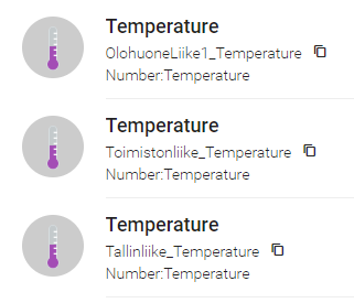

    • I have working Influxdb persistence configuration & grafana setup. I’m getting temperature from one of my sensors continuously into influfdb & grafana. However, when I try to add new sensors their data is not getting into influxdb. I can see their temperature in paperUI. There is no series created for them either.

I’m not sure how to see items configuration created via paperui out from command line but here is my items in paperUI:

Thanks for replys. I got my problems solved and here comes explanation in case anybody is facing something similar.
I had typo in the names of newly added items in persitent file. I corrected this rigth before posting my original question. Just was not patient enough to wait for persistence data to be wrote to influxdb. After fixing this problem one of the two newly added sensors was fixed. Today I found problem with last sensor: It was out of battery :slight_smile: Now both are working with original persistence file and I can start to optimize it.
