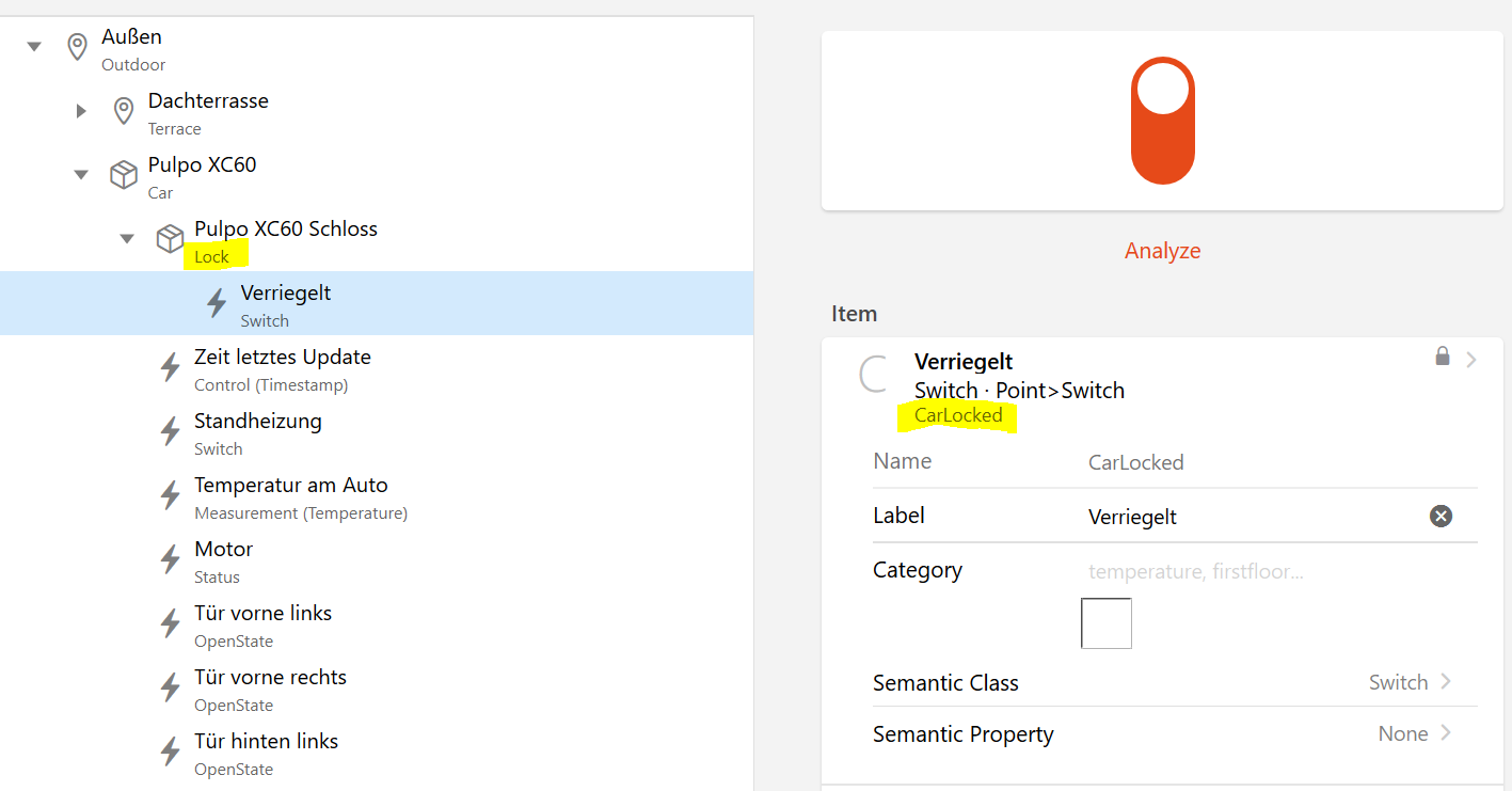

Does the Lock show up at your Equipment “Car”?
I can see it in the Model View:
But it’s not in the Equipment View.
Yes i have it in Equipment View under Locks.
Me too, but not under the Car itself - do you?
Under Equipment Car i have my V70 and if i choose the Car i see the Lock
hmm…

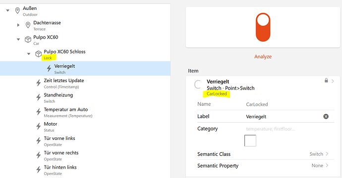

I can see it in the “Model” view:
But not in the Equipment View:
