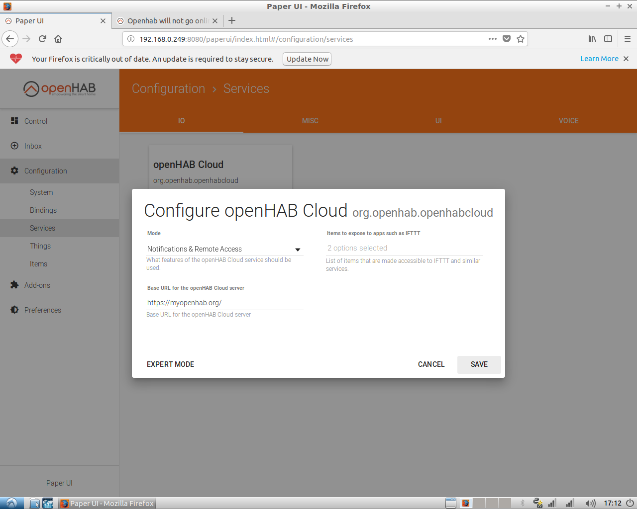

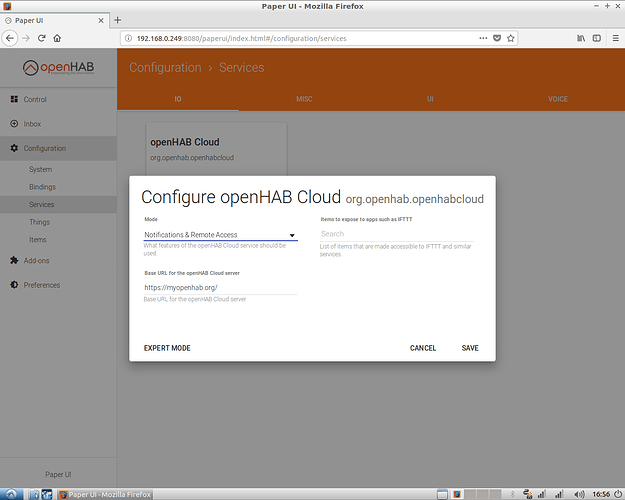

can you post a screenshot from PaperUI → Conf → Services → IO → OH Cloud ?

I will send the screenshot as soon as I am home.

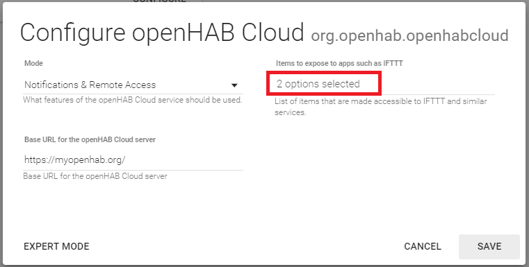

Strange that it doesn’t show how many Items you have selected to expose…
In my case, I have selected 2 and it displays that info:
Can you see them as selected if you browse that list?
yes I took them out yesterday as I tried everything
