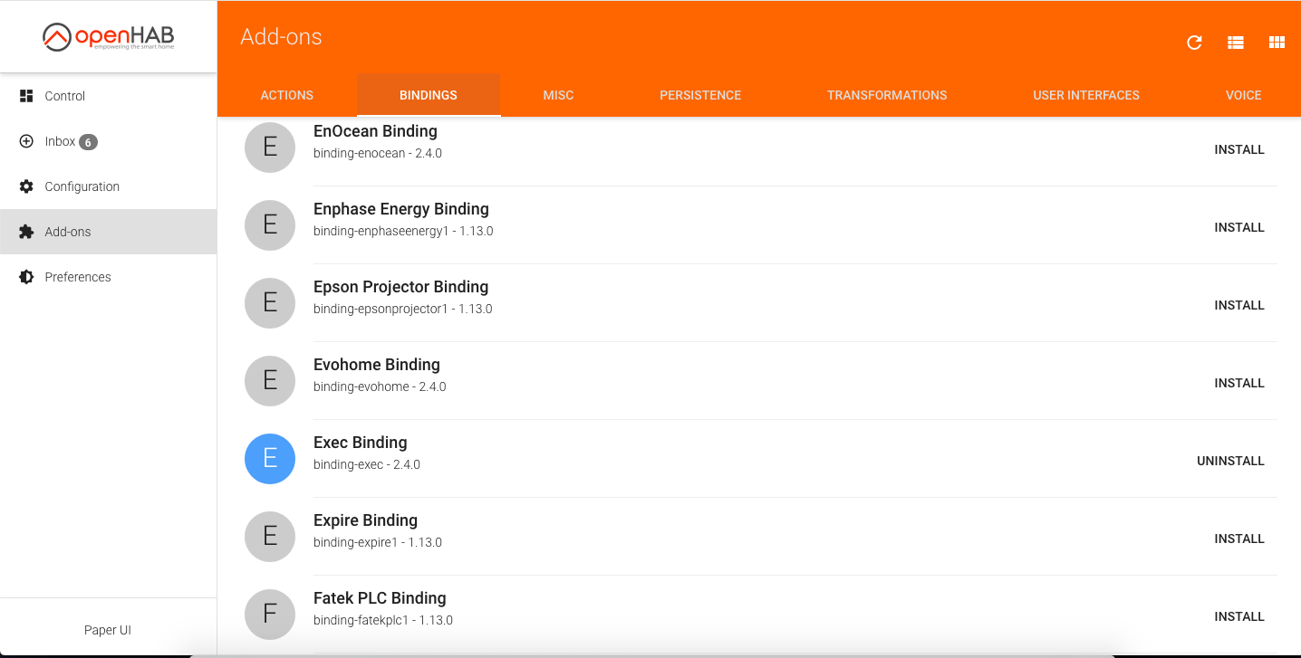

I have installed exec binding this afternoon reboot and it’s the same thing

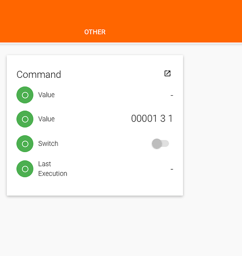

You will understand my doubts now. Show us - screenshot please.
What does your exec Thing look like in PaperUI?
Okay, that’s good.
Nope, those are Items. Please see my example screensho a few posts up for an exec Thing.

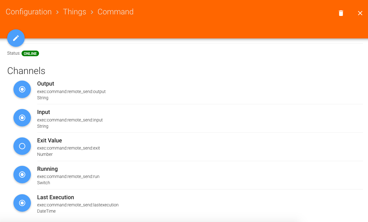

PaperUI > Configuration > Things
gives you a list.
Click for more - it’ll show you channels

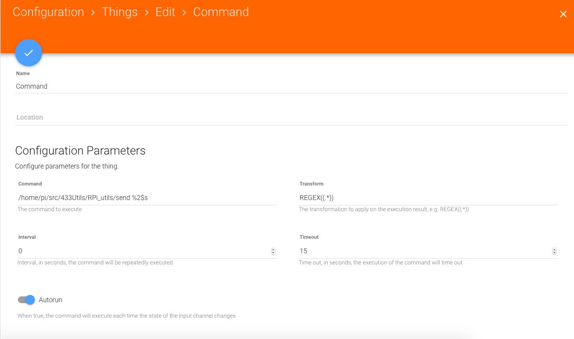

Click the pencil icon - see the setting from your xxx.things file
Okay, that’s good. We’ve come a long way in a week.

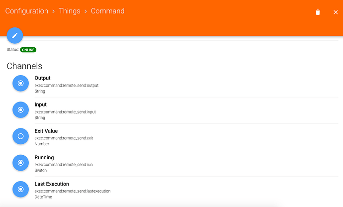

For completeness, can we also see the channels for that Thing (previous screen)
