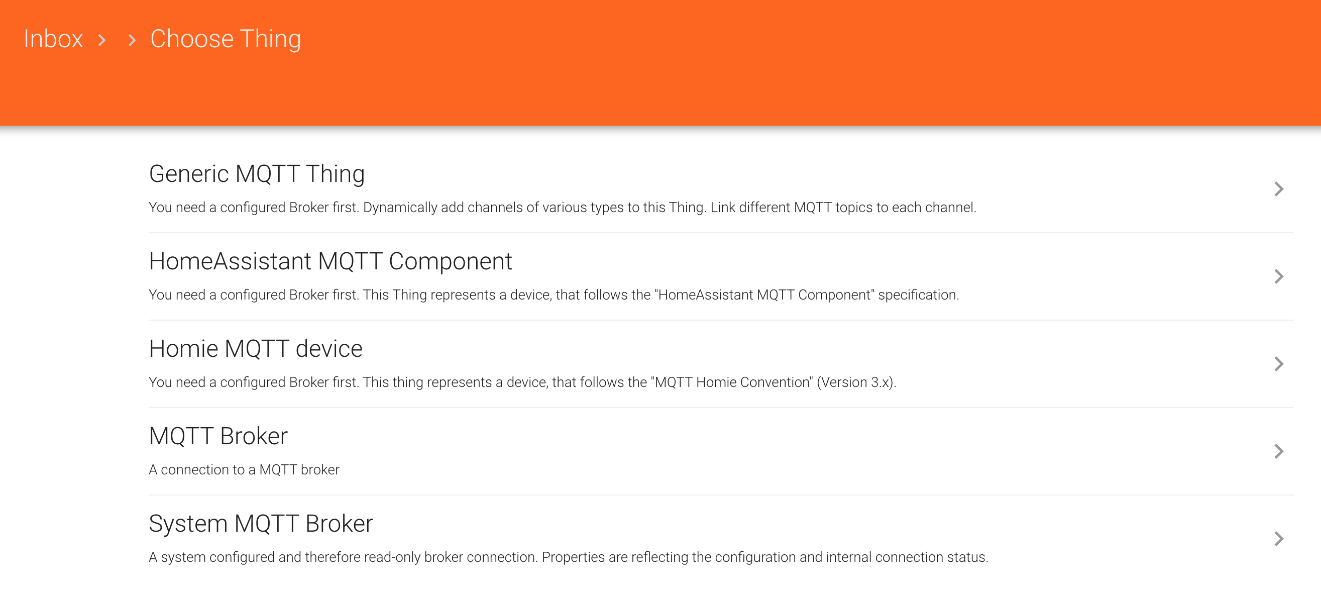

folks, i solved the problem. my environment language is the problem. i added at the top of file
/usr/share/openhab2/runtime/bin/karaf
LANG=en_US.UTF-8
then i see all option in the mqtt option.
thanks for everything…

Thats weird…
How is this related to the thing not showing?
this is from openhab2.log:
2019-09-18 03:47:19.581 [WARN ] [ig.xml.osgi.XmlDocumentBundleTracker] - The XML document ‘/ESH-INF/thing/thing-types.xml’ in module ‘org.eclipse.smarthome.binding.mqtt’ could not be parsed: No enum constant org.eclipse.smarthome.config.core.ConfigDescriptionParameter.Type.İNTEGER : No enum constant org.eclipse.smarthome.config.core.ConfigDescriptionParameter.Type.İNTEGER
if dont see İNTEGER i cant find this solution. İNTEGER must be false, INTEGER is true.
İ is not equal to I.
