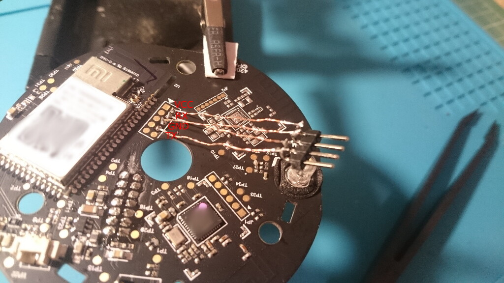

Nope, i’ve been able to connect by serial port to gateway, but xiaomi disabled in latest update downgrade function (flashing custom firmware). I’ve been in contact with Dennis Giese, he knows a lot about xiaomi devices and how to “mod” them. Maybe he will be able to help us.
In attachment UART schema connection:
Good job, why do you want to flash the FW?
…because it’s high possibility that it will restore compatibility with openhab mihome addon and i won’t be forced to re implement all functionality in miio addon.
