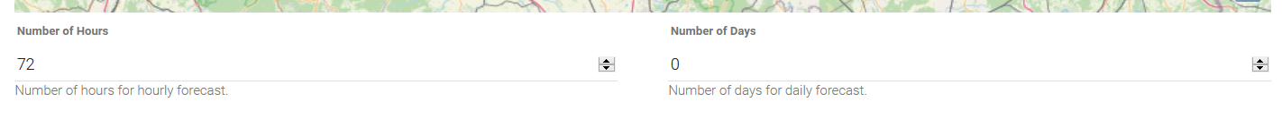

May we see your OH2.5 Thing settings? (weather, not account)

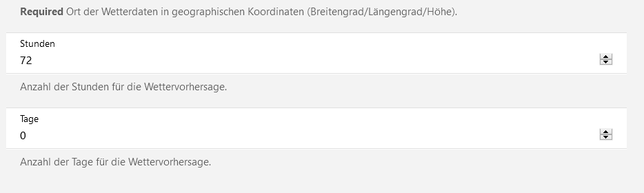

May we see your OH3 Thing settings?

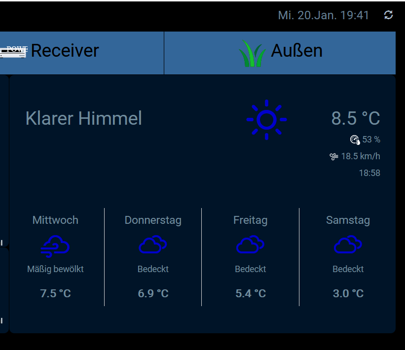

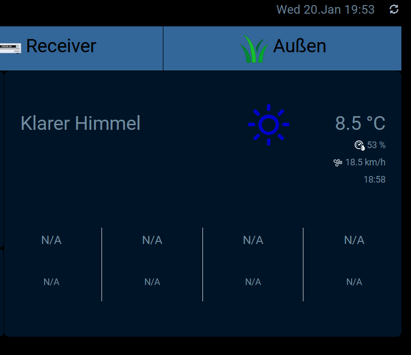

OK, now I’m suprised, because in oh2.5 config “number of days” is 0, too, but I receive the data for condition0 - condition3 and it is show in habpanel widget.
In OH3 today I receive condition3 too, but it is not shown in habpanel:
OH2.5:
Log:

OH3:
Log:
	Line 3386: 2021-01-20 18:24:44.144 [INFO ] [openhab.event.ItemStateChangedEvent ] - Item 'Weather_OWM_ConditionId0' changed from 804 to 802
Line 3614: 2021-01-20 18:58:38.779 [INFO ] [openhab.event.ItemStateChangedEvent ] - Item 'Weather_OWM_Condition' changed from NULL to Klarer Himmel
Line 3615: 2021-01-20 18:58:38.783 [INFO ] [openhab.event.ItemStateChangedEvent ] - Item 'Weather_OWM_ConditionId' changed from NULL to 800
Line 3616: 2021-01-20 18:58:38.793 [INFO ] [openhab.event.ItemStateChangedEvent ] - Item 'Weather_OWM_ConditionIcon' changed from NULL to raw type (image/png): 2817 bytes
Line 3617: 2021-01-20 18:58:38.798 [INFO ] [openhab.event.ItemStateChangedEvent ] - Item 'Weather_OWM_ConditionIconId' changed from NULL to 01n
Line 3621: 2021-01-20 18:58:38.846 [INFO ] [openhab.event.ItemStateChangedEvent ] - Item 'Weather_OWM_Condition0' changed from NULL to Mäßig bewölkt
Line 3622: 2021-01-20 18:58:38.848 [INFO ] [openhab.event.ItemStateChangedEvent ] - Item 'Weather_OWM_ConditionId0' changed from NULL to 802
Line 3625: 2021-01-20 18:58:38.870 [INFO ] [openhab.event.ItemStateChangedEvent ] - Item 'Weather_OWM_Condition1' changed from NULL to Bedeckt
Line 3626: 2021-01-20 18:58:38.872 [INFO ] [openhab.event.ItemStateChangedEvent ] - Item 'Weather_OWM_ConditionId1' changed from NULL to 804
Line 3629: 2021-01-20 18:58:38.897 [INFO ] [openhab.event.ItemStateChangedEvent ] - Item 'Weather_OWM_Condition2' changed from NULL to Bedeckt
Line 3632: 2021-01-20 18:58:38.912 [INFO ] [openhab.event.ItemStateChangedEvent ] - Item 'Weather_OWM_ConditionId2' changed from NULL to 804
Line 3634: 2021-01-20 18:58:38.919 [INFO ] [openhab.event.ItemStateChangedEvent ] - Item 'Weather_OWM_Condition3' changed from NULL to Bedeckt
Line 3635: 2021-01-20 18:58:38.921 [INFO ] [openhab.event.ItemStateChangedEvent ] - Item 'Weather_OWM_ConditionId3' changed from NULL to 804

I’m using the openweathermap Binding with a free Account in OH3. The “ForecastDay” Feature is always 0 with the free Account. What I did is setting the “forecastHours” to 96 (= 5 Days ahead) so I have these values.
I followed this guide GitHub - BasvanH/habpanel-widget-openweathermap: OpenWeatherMap widget for HABPanel (OpenHAB) to automatically fill the Items with the right values (rolling Days ahaed). Just for those looking for a solution working with the openweathermap Binding.
