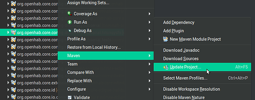

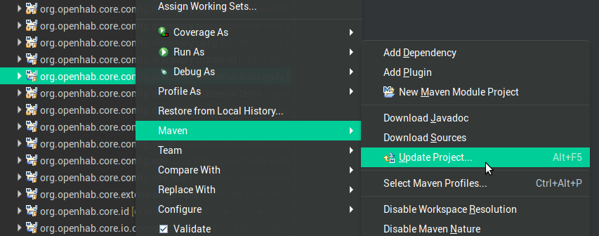

Usually Eclipse will pick up these changes and prompt you to update the Maven project configuration. If it does not you can right click on a project and force it to update the projects:
Then Select All projects and click OK.

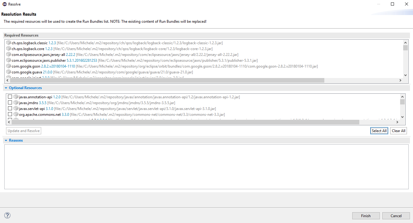

What is unclear to me is all the problems detected by the Resolve window.

I don’t see any in the screenshot?
Without seeing actual errors/warnings/stacktraces I’m afraid nobody can help you with that.
I meant all the Resolve options

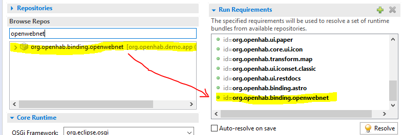

I could not get the binding and then drag it.
No type of error, simply with was listed.
Then with the mvn -DskipChecks -DskipTests clean install -U command I succeeded.
I don’t know what changes from the mvn and Build Automatically command from Eclipse IDE
It’s not really clear to me how bnd resolves dependencies and when it considers something optional. That important piece of information is also missing from the documentation. :neutral_face: It also has all voice add-ons and some bindings in the list of optional bundles but not all bindings? So usually I don’t select any optional dependencies. I only had to select the optional rxtx bundles while debugging a binding depending on serial communications.

These are the steps I used to get debug with Eclipse IDE

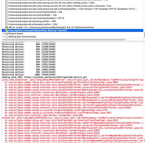

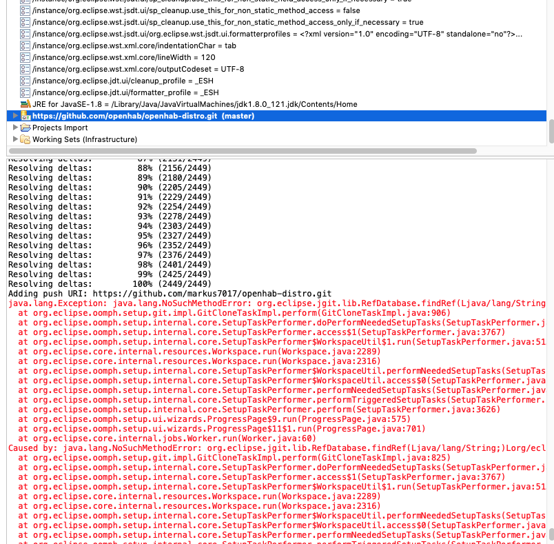

trying to do a fresh install of the 2.5 IDE on macOS/Eclipse results in
are there any pre-requisites? Is the current status results in a consistent setup?
