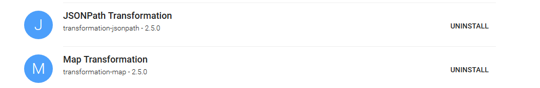

Hi Rossko57,
I did install MAP prior to using the service. See image:
I think it is complaining about the missing file not the service.
