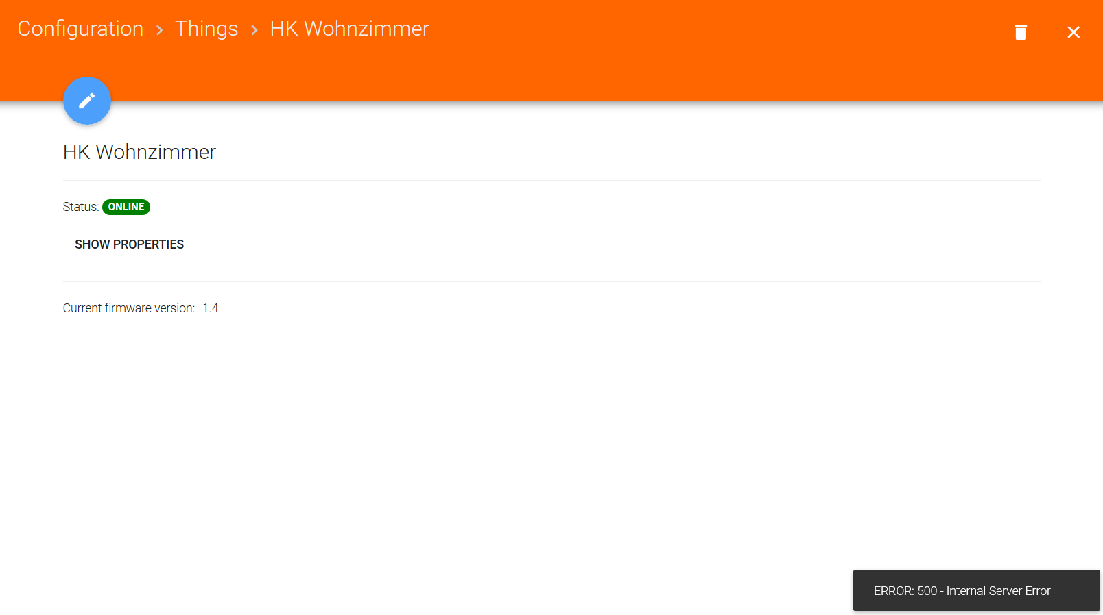

Things for the gateway, virtual remote and the HM-CC-RT-DN appear in the inbox, but the HmIP-SRH not.
When i want the add any of the homematic devices as a thing, paperui shows error500 without an entry into the log. I even can add the thing, but then i cant add/link an item to the thing in paperui (and get error500, again):
even i tried to config the .things and .items files manually, but without any difference.
