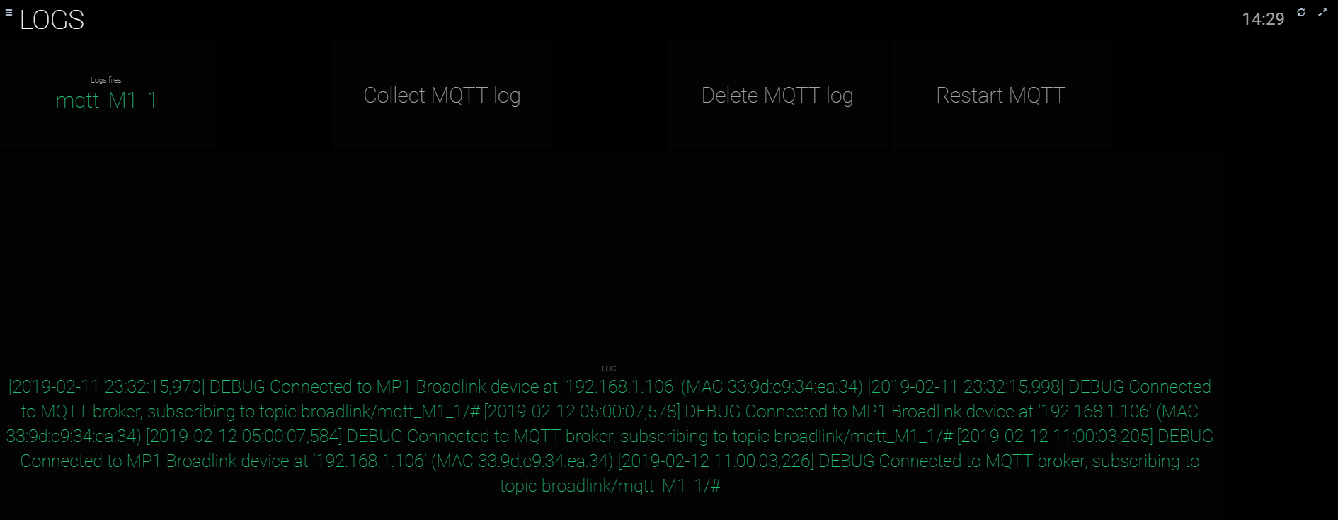

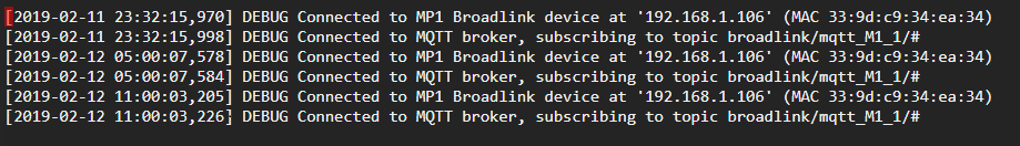

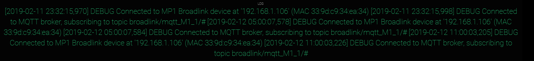

This is a HABPanel question. I don’t use HABPanel. But it does look like the text is center justified. Yoo might try left justification which might be easier to read.
The last line isn’t truncated, it wraps to the next line. The first part of that line is on the previous line.
