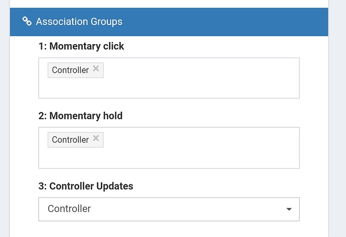

i know it’s impossible to understand if there are issues on my side without text files. since i’m mostly testing before setting up a PI, my configuration is PaperUI/text file mixed.
i can’t add PaperUI generated items to my text files at the moment, i’ll post them later if needed.
i’ll just need a couple of confirmation for further ‘investigation’
does the position value updates when using wall switches wired into the fgr-222?
it does not in my configuration
is it supposed to be updated?
is blind item value supposed to update using the following configuration? it does not update correctly to me
