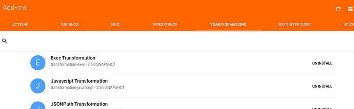

You also need to install the transformation service in the paperUI
Yes that one

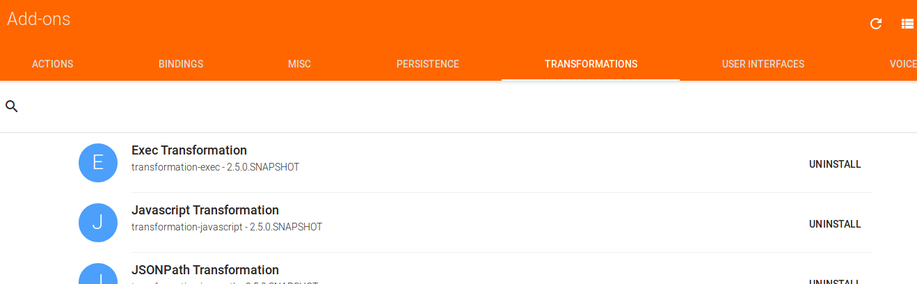

Yes, transformation service already installed. Same result. What am I missing?
I have install json transformation. I need the java one as well?
Yes you need to javascript transformation service
The javascript transformation was the missing piece. Thanks so much!
