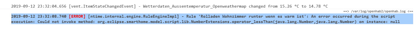

i’ve tried to adjust the rule in the java.- direction with “{” / “}”:
rule "Rolladen Wohnzimmer runter wenn es warm ist"
Item Wetterdaten_Aussentemperatur_Openweathermap changed
if ( (Wetterdaten_Aussentemperatur_Openweathermap.state as Number ) < "25")
{Rolladen_Wohnzimmer_BlindsControl.sendCommand(50)}
logInfo("Wetterdaten_Aussentemperatur_Openweathermap", "Value = " + Wetterdaten_Aussentemperatur_Openweathermap.state.toString)
if ((Wetterdaten_Aussentemperatur_Openweathermap.state as Number) < 25) {
There are two approaches to this.
Convert the Number:Temperature to a plain number or compare with a temperature:
Solution 1:
if ((Wetterdaten_Aussentemperatur_Openweathermap.as QuantityType<Number>).doubleValue < 25) {
Solution 2:
if (Wetterdaten_Aussentemperatur_Openweathermap.state < 25 | "°C") {
