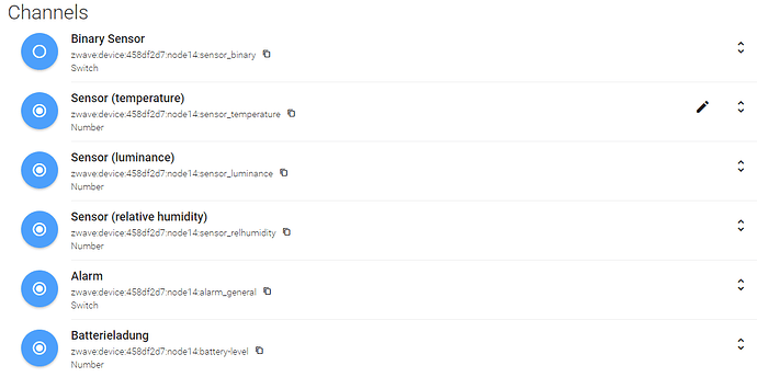

After including the thing via Paper UI, the following items show up:
Assuming that the Alarm (alarm_general) item is the item which is responsible for the motion sensor, the expected behaviour would be that the PIR sensor triggers and resets after a defined time.

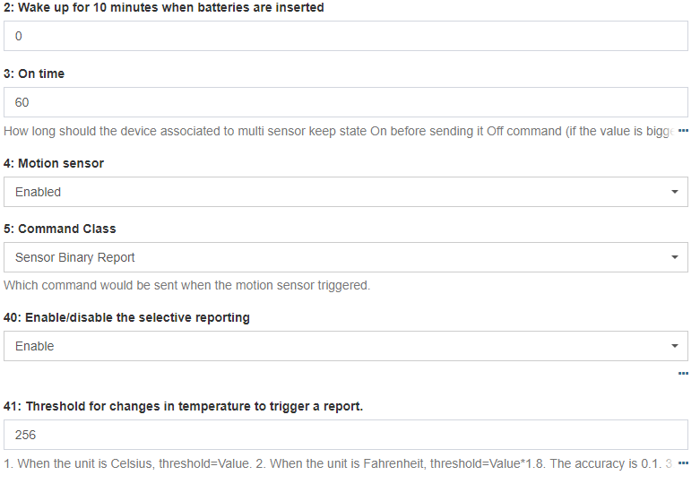

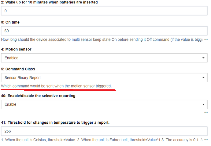

I have configured the thing like this:
The items are configured via items file
Number Temperatur_Kellertreppe_Multisensor "Temperatur Kellertreppe" <temperature> (gKellertreppe,gTemperatur,Kel_Kellertreppe,gSensor) {channel="zwave:device:458df2d7:node14:sensor_temperature"}
Number Lichtstaerke_Kellertreppe_Multisensor "Lichtstärke Kellertreppe" <light> (gKellertreppe,Kel_Kellertreppe,gLicht,gSensor) {channel="zwave:device:458df2d7:node14:sensor_luminance"}
Number Luftfeuchte_Kellertreppe_Multisensor "Luftfeuchtigkeit Kellertreppe" <humidity> (gKellertreppe,Kel_Kellertreppe,gLuftfeuchte,gSensor) {channel="zwave:device:458df2d7:node14:sensor_relhumidity"}
Number Bewegung_Kellertreppe_Multisensor "Bewegung Kellertreppe" <motion> (gKellertreppe,Kel_Kellertreppe,gBewegung,gSensor) {channel="zwave:device:458df2d7:node14:alarm_general"}
Number Batterie_Kellertreppe_Multisensor "Batteriestand Multisensor Kellertreppe" <battery> (gKellertreppe,Kel_Kellertreppe,gBattery,gSensor) {channel="zwave:device:458df2d7:node14:battery-level"}
But I can’t get the PIR to reset. I can see that the sensor switches to “1” but never resets. Like this, I will never be able to set any rule on it - so, what can I do to get it working?

I would assume you need to activate the Binary channel and have this to trigger your alarm rules.
Given it is called “binary sensor” i will assume it uses 0 (zero) / 1 or ON / OFF as output with current setting.
No i do not have this multisensor but is about to order at least one of this or similar type from another brand.
@Formula400Pontiac: Thank you for your help - that was exactly the issue…
Wrong sensor. :grimacing:
