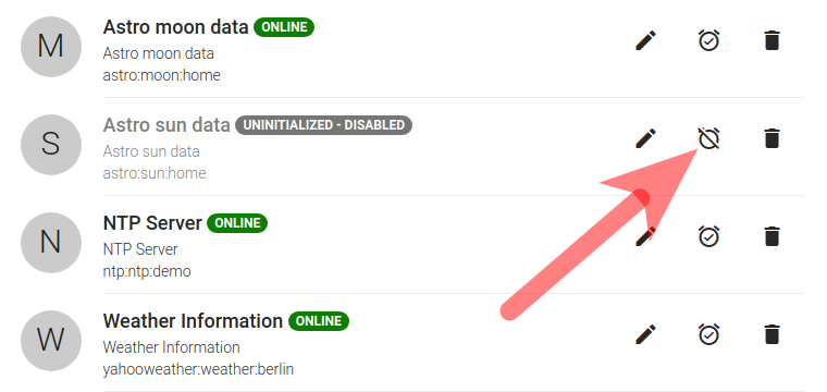

I always disable the in the evening:
The disable function will be available in 2.4.9. M8? In M7 i only see the pencil and the trashbin. But in the things edit page of PaperUI there is a “disable” button at the bottom.
Yes it will be. It’s already in the latest SNAPSHOT builds. The Disable button you already see has the same functionality. It was later moved to Thing overview you see in the screenshot. A good change, because I often instinctively clicked it for showing “more channels”.
