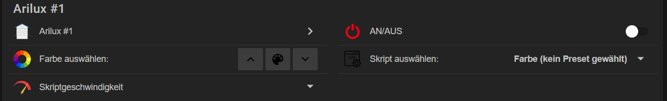

It’s looking right this atm:

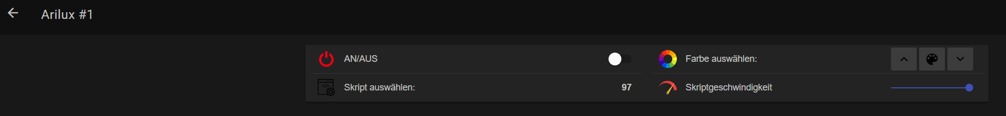

But obviously “Skript auswählen” shouldn’t just show a string or value
It should look like this:

It’s already in a frame, as you can see in the second picture, wanted to redesign my code with the Arilux Group.
