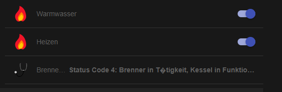

I have an incoming String from Mqtt and display this on Basic UI and iOS App.
I do´nt get the complete text displayed because the textfield is too small.
I also have problems to display Umlaute ÄÖÜ and “ß” correctly.
Both files Items and Sitemap file are UTF8 encoded.
After a short google hunt, I found something that is related to Mqttfx. It seems Mqttfx does not send the Umlaute correct. By trying sending a message from the Mosquitto Broker like:
mosquitto_pub -h 192.168.0.101 -m “ßÄÖÜ” -t Home/inside/Heating/Brennerstatus
OpenHab displays everything in the correct Format. So it is not a OpenHab related problem.
At the moment I am using mqttfx for test purposes until I get my Control Unit for my old Heatingsystem done.
