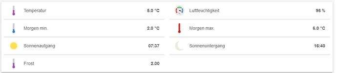

Number Temp_Frost "Temperature Frost [%.2f]"{weather="locationId=home, forecast=1, type=temperature, property=min"}
Item shows nicely in sitemap using
Text item=Temp_Frost label="Frost" icon="temperature"
