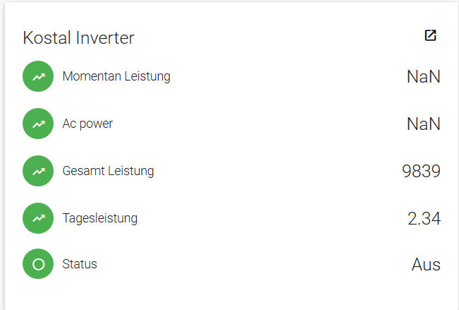

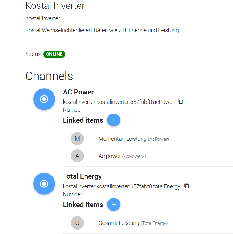

Suddenly I get no data displayed in basic ui or classic ui. I can see the data in PaperUi, so the binding and the communication works. I am not aware of any changes from 2.4 to 2.5 that could lead to that behavior. Please give me some advice how to solve the issue.

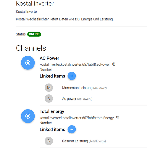

Here are two of them:
OK I could solve the problem. The issue was a double definition of the Kostal items. They were originally defined in the items file as documented above. The new binding changes obviously something. I had to delete the definitions in the items file. Delete the binding. Open it again in the inbox and then assign the items again in PaperUI. After that it works as designed.
