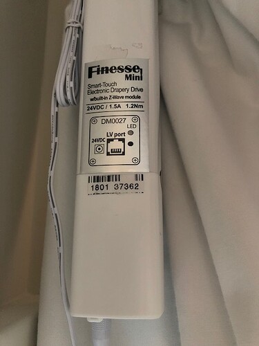

I have 6 of these drapery motors and the very awesome and helpful people @chris and @sihui were able to recently add it to the ZWave database as a supported device and it works perfectly.
You just need the motors only, they have built in ZWave chips in them…are included into your network like any other ZWave device and you do not need any further hardware or bridges…just need to have the blind motors powered up…they are also capable of running on battery packs but I wouldn’t suggest that.
I am just not sure if they are available in your area with your ZWave Frequency…I am in Canada.
Finesse.pdf (372.8 KB)
These were for drapery, but I believe they have larger ones for Rollshutters as well.
