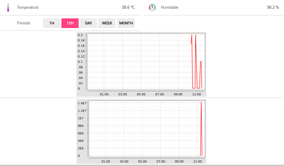

I’m tried to replicate what you show to me about the graph. But the values appear strange, I divided into 2 graphs to try to see what is occuring. As you can see in the image, the values are strange. It is receiving the correct values, but it is drawing strange values.
The first graph represents the Temperature and the second the Humidity, I divided because (as you can see) the temperature have values so low that do not appear.

As you can see, it is almost equal to your code. But the values are strange.
Since you are persisting the items directly (and not only the groups) you could use the items directly on the charts (you are showing one item per chart anyway). I’d try that.
If that doesn’t help try stopping OH, deleting all .rrd files (to be found in /ar/lib/openhab2/persistence/rrd4j) and restarting OH.
Such is needed if (for example) the item type has been changed after the .rrd file has been created.
I’m using the same setup, however without the groups, and my charts are working as the ones from @H102. Your basic setup seems to correct (see the actual temp and humidity readings), the problem is either with the database or the chart creation.

Your item ValuesBathroomTemp is not needed because it’s already being persisted by the items group HomeSensorChart*.
My chart is working with both items listed as shown above (item and group in persistence), but it shouldn’t be required to list both. You can test by commenting out the item and use only the Group with // . Like this:
Items {
        // additionally persist Items
        HomeSensorChart* : strategy = everyUpdate, everyMinute
        HomeSensorChart2* : strategy = everyUpdate, everyMinute
//      ValuesBathroomTemp : strategy = everyUpdate, everyMinute
//      ValuesBathroomHumi : strategy = everyUpdate, everyMinute
If your still having an issue, test further by commenting out HomeSensorChart2* and try to get just one reading to chart, then add on.
