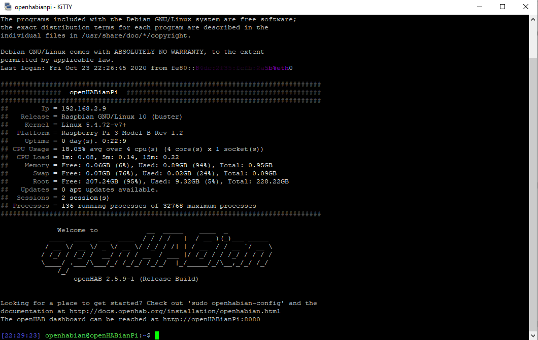

The only error I see from your log above is this one:
$ FireMotD -G Gray
You specified a non-existant option: -G
FAILED
When you start openhabian-config… On top right you should see the version number… Can you post ist here?

openHABian Configuration Tool [stable]v1.6-880(769ea17)
Ok, that’s the same version I’m using… Let’s do:
ls -al /usr/local/bin/FireMotD
It should look like:
-rwxrwxr-x 1 root root 91170 Mar 18 2020 /usr/local/bin/FireMotD
If your file is older, we will try to update manually…
-rwxr-xr-x 1 root staff 46040 Oct 23 21:51 /usr/local/bin/FireMotD
Ok, it’s current… hm… Let me quickly write down how to update manually…
Please run:
sudo curl -s https://raw.githubusercontent.com/OutsideIT/FireMotD/master/FireMotD -o /tmp/FireMotD && chmod 755 /tmp/FireMotD && sudo /tmp/FireMotD -I -d && /tmp/FireMotD -G all -d
chmod: changing permissions of '/tmp/FireMotD': Operation not permitted
That’s weird… Ok, then let’s try this:
sudo su -
That was long:
[22:12:07] root@openHABianPi:~# curl -s https://raw.githubusercontent.com/OutsideIT/FireMotD/master/FireMotD -o /tmp/FireMotD && chmod 755 /tmp/FireMotD && sudo /tmp/FireMotD -I -d && /tmp/FireMotD -G all -d

DDDDDDDDDDDDDDDDDDDDDDDDDDDDDDDDDDDDDDDDDDDDDDDDDDDDDDDDDDDDDDDDDDDDDDDDDDDDDDD
iiiiiiiiiiiiiii openHABianPi iiiiiiiiiiiiiiiiiiiiiiiiiiiiiiiiiiiiiiiiiiiiiiii
ggggggggggggggggggggggggggggggggggggggggggggggggggggggggggggggggggggggggggggggg
DD Ip -> 192.168.2.9
DD Release -> Raspbian GNU/Linux 10 (buster)
DD Kernel -> Linux 5.4.72-v7+
DD Platform -> Raspberry Pi 3 Model B Rev 1.2
DD Uptime -> 0 day(s). 0:6:15
DD CPU Usage -> 2.02% avg over 4 cpu(s) (4 core(s) x 1 socket(s))
DD CPU Load -> 1m: 0.58, 5m: 0.71, 15m: 0.41
DD Memory -> Free: 0.09GB (10%), Used: 0.85GB (90%), Total: 0.95GB
DD Swap -> Free: 0.07GB (80%), Used: 0.01GB (20%), Total: 0.09GB
DD Root -> Free: 207.22GB (95%), Used: 9.34GB (5%), Total: 228.22GB
DD Updates -> 0 apt updates available.
DD Sessions -> 0 session(s)
DD Processes -> 135 running processes of 32768 maximum processes
SSSSSSSSSSSSSSSSSSSSSSSSSSSSSSSSSSSSSSSSSSSSSSSSSSSSSSSSSSSSSSSSSSSSSSSSSSSSSSS
2020-10-23 22:13:29,734: FireMotD: Info: Chmod 0775 /usr/share/firemotd
2020-10-23 22:13:29,752: FireMotD: Info: Chmod 0776 /usr/share/firemotd/data/FireMotD.json
2020-10-23 22:13:29,772: FireMotD: Info: FireMotD action install finished

and now please try:
/tmp/FireMotD --theme gray
Seems to work but only in this window. When I open a new SSH still no IP.
[22:17:26] root@openHABianPi:~# /tmp/FireMotD --theme gray
############### openHABianPi ################################################
## Ip = 192.168.2.9
## Release = Raspbian GNU/Linux 10 (buster)
## Kernel = Linux 5.4.72-v7+
## Platform = Raspberry Pi 3 Model B Rev 1.2
## Uptime = 0 day(s). 0:10:42
## CPU Usage = 0.75% avg over 4 cpu(s) (4 core(s) x 1 socket(s))
## CPU Load = 1m: 0.35, 5m: 0.46, 15m: 0.38
## Memory = Free: 0.05GB (6%), Used: 0.89GB (94%), Total: 0.95GB
## Swap = Free: 0.07GB (80%), Used: 0.01GB (20%), Total: 0.09GB
## Root = Free: 207.21GB (95%), Used: 9.35GB (5%), Total: 228.22GB
## Updates = 0 apt updates available.
## Sessions = 0 session(s)
## Processes = 136 running processes of 32768 maximum processes
That’s clear… So we have 2 things left:
Overwrite the existing FireMotD with the new version (as root-user)
cp /tmp/FireMotD /usr/local/bin/FireMotD
Edit your .bash_profile (openhab-user) and replace
bash /opt/FireMotD/FireMotD --theme gray
by
/usr/local/bin/FireMotD --theme gray
in .bash_profile which lines need replacing?
if [ -f /opt/FireMotD/FireMotD ]; then
echo
fi
Oh I see… please replace all
by
Thank you.
If you want to clean up, you can remove /opt/FireMotD completely… Also the update via openhabian-config should work now…
Do you have any idea why this was not updated and why do I have 2 copies also in /opt ?
Well… I can only guess that you installed openhabian some time ago… I rebuild my test-env weekly and the default-path of the latest openhabian for FireMotD seems to be /usr/local/bin/FireMotD. Instead your .bash_profile pointed to /opt/FireMotD/FireMotD. If you run:
/opt/FireMotD/FireMotD -V
I would expect that you still get the old version reported right?
Correct. When I run the /opt instance I get the old version.
[22:32:54] root@openHABianPi:~# /opt/FireMotD/FireMotD -V
FireMotD v7.05.170509
[22:33:26] root@openHABianPi:~# /usr/local/bin/FireMotD -V
FireMotD v12.05.191019
