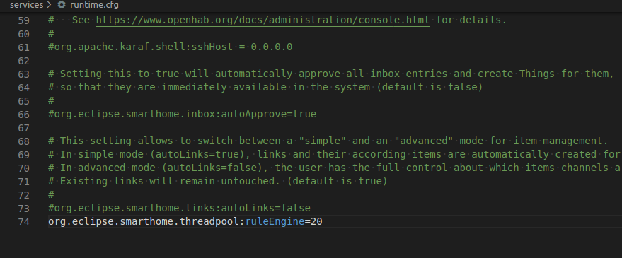

From the Karaf console run this command shell:threads --list |grep -i “ruleEngine” and post the output.
You may need to add org.eclipse.smarthome.threadpool:ruleEngine=20 in runtime.cfg if you have system rules that are overloaded.

Add this line org.eclipse.smarthome.threadpool:ruleEngine=20 at the bottom in etc/openhab2/services/runtime.cfg (see pic below) then clean cache and reboot.
Are you using VSCode or something other like nano to edit files?

yes, i use VScode. I edited the config, made a clean cache and restart.
The result:
2019-11-23 16:40:14.099 [INFO ] [.eclipse.smarthome.model.script.rule] - start timer
2019-11-23 16:40:44.118 [INFO ] [.eclipse.smarthome.model.script.rule] - timer executed
So happy you saved my day!
