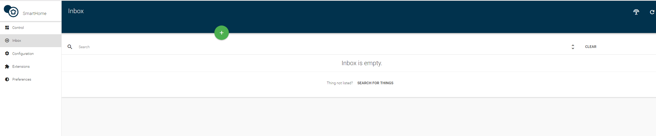

Even more strange is paperUI is no longer availble from openhab´s main dashboard. But I can enter it using a direct link to it:
http://IP_OF_RPI:8080/paperui/index.html#/inbox/search
But It looks like this:

I did however change to install the 2.5 snapshot insted. And now I got rid of the above error, and PaperUI looking normal again, and available through the dashboard as well.
