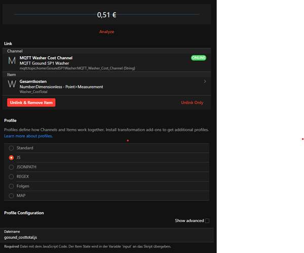

Then I set up a JS transformation to retrieve the MQTT topic string as input, perform a RegEx match to get the Total Power consumed value and multiply that value by my current electricity price. The item page looks like this, with the linked channel and JS transformation file:
The JS transformation file looks like this (be gentle I am no coder, forum posts combined with trial and error ):

Problem: As you might have noticed, the current energy price is “hard coded” into the JS transformation file. This leads me to What I want to have: I want the current energy price to be passed to the JS transformation as an additional parameter, which is taken from a corresponding item.
I read on the JS transformation page [Link] that additional parameters can be passed to a JS transformation script. I changed the whole thing around a bit. The page of my Test26 item now looks like this. Notice that I am using a different JS file and added ?price=0.22
behind the JS filename:

So far, so good. Now I have the energy price no longer in the JS transformation file but hardcoded into the item settings in Main UI. And this is where I am stuck!
Question: Can I somehow reference an item state in my item’s profile configuration?
I have tried the following lines (energy_electricity_price is a number item with value 0.22):
gosund_costtotal_price.js?price=energy_electricity_price.state
gosund_costtotal_price.js?price=items.energy_electricity_price.state
gosund_costtotal_price.js?price=http://192.168.178.23:16680/rest/items/energy_electricity_price/state
gosund_costtotal_price.js?price=items.getItem(“energy_electricity_price”).state
In all above cases, no item state is transferred as an additional parameter to the JS transformation. Instead the string after the “=” sign is transferred. E.g. for the first case the string “energy_electricity_price.state”.
I am completely clueless how to call an item state within the item’s profile configuration, or whether this is at all possible? Maybe the item state could be called within the JS transformation file?
